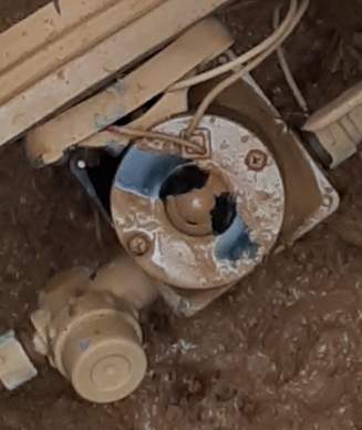

Ah, here's the pump. Any ideas on brand and model? Neither the contractor nor the supplier remember (long story).
# Posted: 2 Jul 2021 05:27am
The tag is on the side of the motor. Has it been in a mud pit long?
