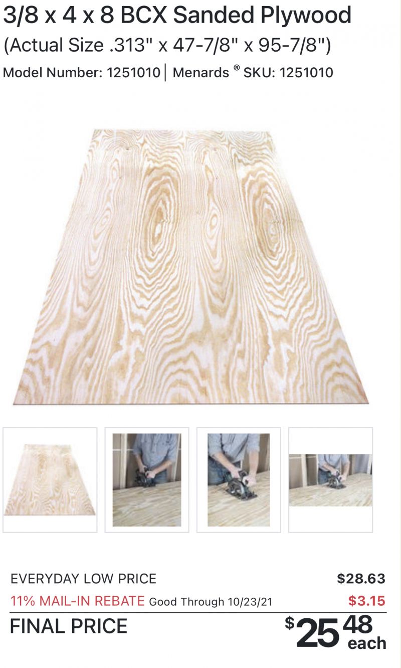

I’m ridiculous. I just shut my cabin down for the winter yesterday and am thinking about next year
Anyways we’re going to finish the interior with board and batten and paint white. Should look great.
Battens are easy.. but What should I use for sheathing?
Important point. I have to carry all this sheathing up a bluff and back 100 yards. I’ve carried over 100 pieces of 1/2 and 3/4” plywood already and really don’t want to anymore!!!
Battens every 2’ vertical. Should hit studs on seams …Sheathing would be vertical.
Here my additional thoughts/ concerns.
1. 1/4” would be great but I feel it would be too flimsy and/ wavy between studs. Am I right?
2. If 1/4” then I can get sanded plywood or MDF panel which would paint nicely- but again worried about waviness.
3. Would waviness though be noticeable if I have a batten every 2’?
4. If I need to beef it up, then 3/8??? Or should I do 1/2? ( I don’t want to do 1/2 lol).
5. Sanded plywood or mdf… and other material I missed since I’m painting it?
6. Vertical sheathing right? Horizontal seems I’d have this seam/batten at 4’ which i would think is undesireable?
7.Other thoughts/ concerns?
# Posted: 18 Oct 2021 12:42pm
1/4" aint 1/4", it is less; go 3/8", which is also less; think of it as honest 1/4"+

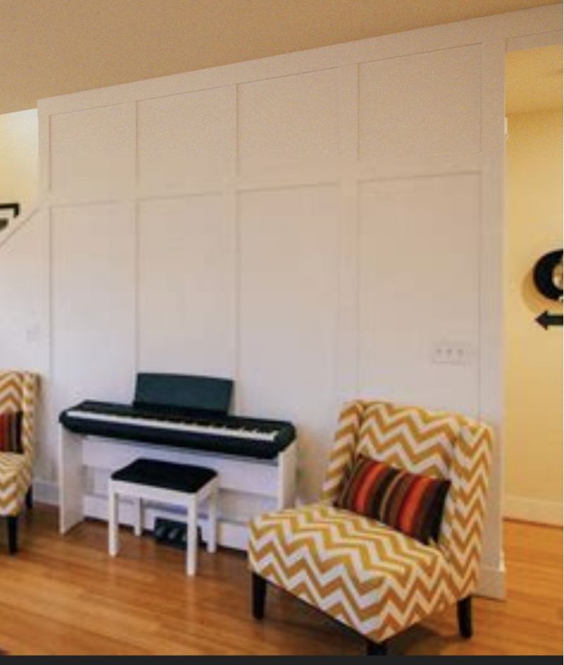

Exactly. The plywood would be the sheathing on the walls and battens trim nailed to face over it and to cover seams. Maybe 2’ spacing on battens, maybe 4’… not sure yet.
This is just an internet photo… but this is the look we’re going for.

I work at a lot of high dnd new construction jobs and when the carpenters build what you pictured they either use birch plywood or mdf
Grizzlyman
# Posted: 21 Oct 2021 08:36am - Edited by: Grizzlyman
Quoting: Irrigation Guy
Perfect. Typically on top of drywall though right? I’m wondering what thickness to use to keep it from being wavy.

This is not what I would call "Board & Batten" this is Panel & Board. I've done similar stuff and learned a couple of quick lessons.

I wouldnt consider this board and batten. It's more like shaker wall panneling. Some type of cabinet grade plywood would be my first choice. But you can really prob do the same thing with drywall and trim boards.

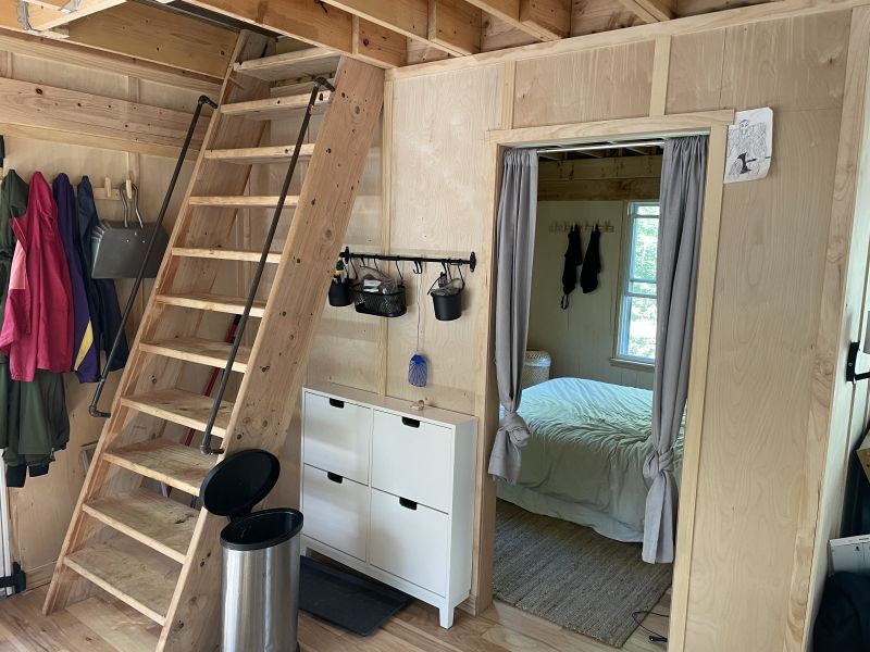

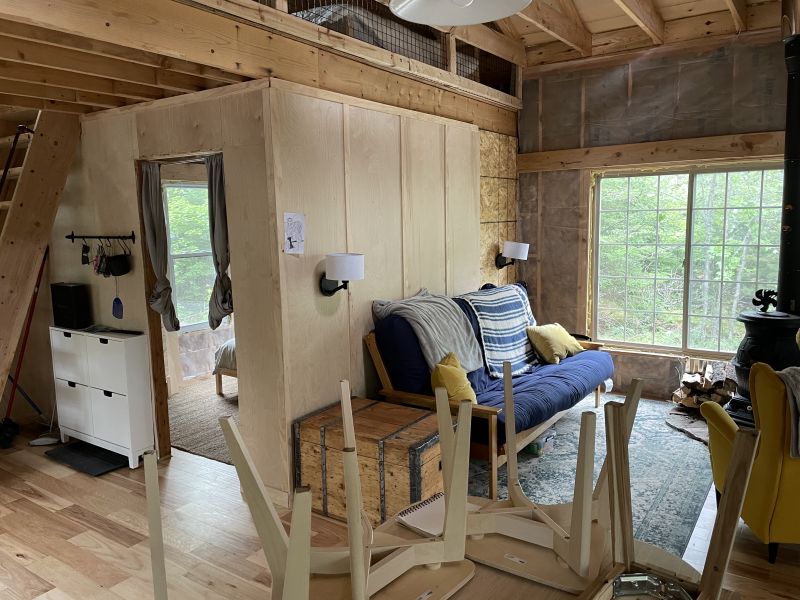

# Posted: 27 Jun 2022 07:19pm - Edited by: Grizzlyman
Thought I’d bring this full circle. Started with the board and batten look this last weekend. 1/4” nice birch plywood w/ 1/4”x2 1/2 battens.
We really like the look of it. 1/4” plywood is more than enough and not wavy at all. It’s also super light. Using wood veneer core instead of the mdf garbage.
Plywood is $45/sheet and Battens are $6 each… just stupid ridiculous prices…Nothing is cheap anymore so I’m just biting the bullet and paying it. I could rip my own battens but frankly don’t want to deal with all the sanding that would result and the prices for pine boards even would result in only minimal savings.
It’s going to take about 35 sheets to finish the interior.
All we be painted white. Using cabinet grade birch plywood for as nice a finish as possible when painted. Only have a few of the battens up as of now.

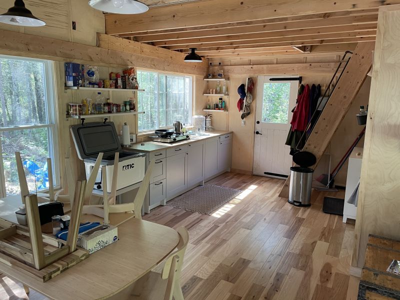

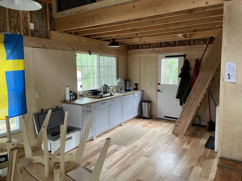

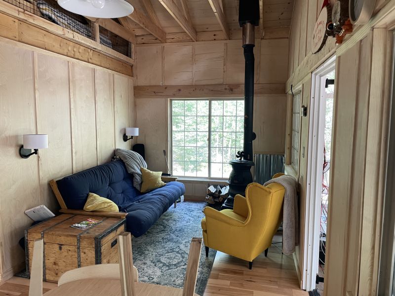

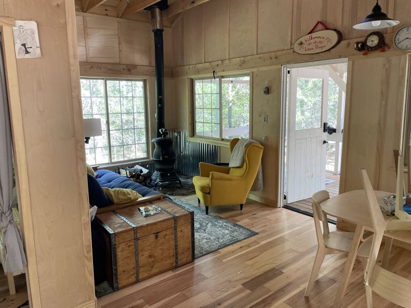

# Posted: 18 Jul 2022 07:24am - Edited by: Grizzlyman
Just finished the interior completely this weekend. It will be painted white. We just love the look.
This took about 35 sheets of plywood and somewhere around 150+ battens.
Interior done! 👊
# Posted: 18 Jul 2022 10:23am
Wow that looks real good. Seems your instincts were correct
rpe

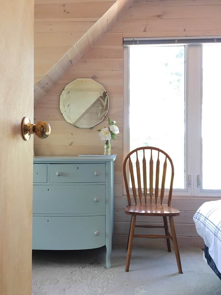

# Posted: 18 Jul 2022 08:14pm
Looks great! It does seem a shame to cover up the nice wood look though. Have you considered a white-wash rather than paint? That might preserve the look of the wood, while still brightening the space. We did that in our master BR, and are very happy with the result. We had a couple different batches of pine, and they all blended nicely after the whitewash treatment. Our local Benjamin Moore store has a recipe for a white-tinted polyurethane that we used for the whitewashing. We used 1-2 coats depending on area.
Whitewash
Whitewash
Grizzlyman
# Posted: 18 Jul 2022 10:57pm - Edited by: Grizzlyman
rpe
Yes! We were actually just talking about that today!!!
It is very nice in natural wood as is and maybe a light whitewash would be better than the original plan of opaque white.
I did unfortunately orient a few panels above the big window the wrong direction to use up scraps…. I even thought about it as I was doing and said “it’s just going to be painted… what’s the big deal “…lol. Will have to redo probably if we keep the grain exposed with a whitewash.
Still undecided… but love the feedback and totally agree!
