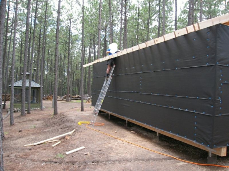

# Posted: 24 Dec 2021 01:52pm - Edited by: ICC
I don't have any pictures of wrinkle free, nice and tight building felt, on my phone, so I cannot post one right now, but when we installed felt there were no wrinkles or at worst minimal wrinkles... Nothing that would cause a lump as the siding was installed. . So, IMO, if one has wrinkles large enough to cause problems that meets my criteria of being not installed correctly.
# Posted: 24 Dec 2021 02:36pm
Found an image of some building felt covered walls a friend did years ago hidden in some old photos I forgot I had on the phone. All by himself too. I did a crude edit on my phone cutting out his face as I do not permission to post.
Tight felt
Tight felt
