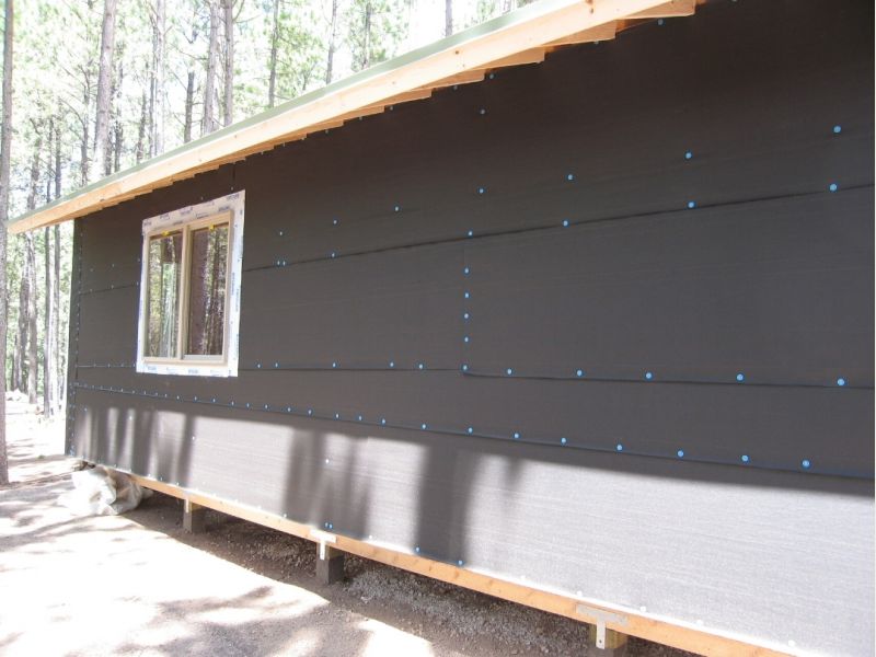

Jackpot! Another. Same wall a couple of months later.
Still tight felt, no tears, etc.

That's possibly the nicest tar paper job on a wall I have ever seen. Even used cap staples too. Did he do that with a gun?
Posted: 24 Dec 2021 08:25pm
He did it with a claw hammer. Those are ring shank roofing nails with plastic caps. We bought them in 50 lb. boxes.
He did have his wife help with holding the strips. They unrolled and cut lengths to go down the side. Then each held an end up, he nailed a wood disk with a single nail in his top corner. Somehow. I don't recall the details. Then the other end was temp nailed to get the height of the strip set. Pushing, pulling it tight he worked from his end to her end. That was more or less what I recall being told. Nine foot OSB panels from top plate down over the rim joists. That is why there is a narrow strip down the length. 30 foot wall length.
It is one of the nicest paper jobs to be seen, all the more because he was a DIY homeowner who never worked in the building trades.

It was also a windless day I believe. About 2 months exposure between first felt installed and when the siding was started. He used true rough sawn 1x3 air dried pine from the Pueblo sawmill for vertical furring and nailed Hardie cement fiber 12" lap siding to that. 2008 was the year. Amazing that I found the pictures still on my phone but I do transfer

That puts my install to shame.
