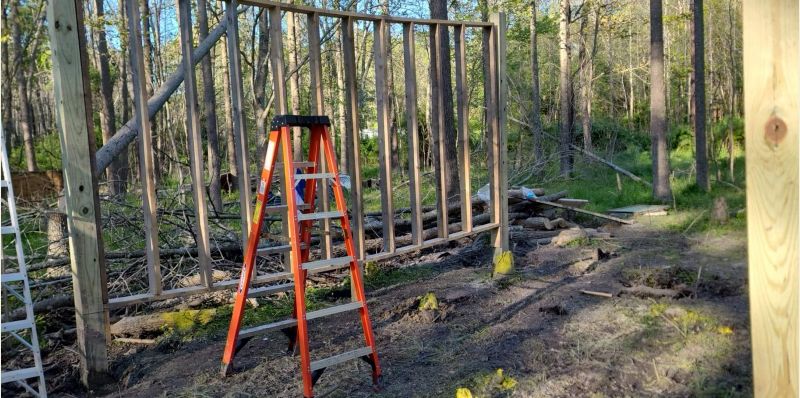

New to SCF. Building a 16x16. Need help with Roofing and Framing.
Hello everyone! I've on this site for a while no learning new information and applying it to my build
I'm building a 16x16 cabin with an A-frame roof.
I have a basic knowledge of carpentry and have been researching cabin builds for almost 5 years.
So far I have dug my posts, 6x6x16's, and am in the process of framing.
The goal is to get this cabin done by Spring as I trying to move on my property by then.
Can any offer tips? I will include a few pics.
I started building the first wall with my neighbor last March. Due to unforseen problems, I was unable to return to the build until September. Will have to knock it down as it is sagging.
I'm in a flood zone and my neighbor suggested raising the floor at least 2-3 feet off the ground.
This has been the hardest undertaking of my life so far and any help is greatly appreciated! Thanks!

I think you should buy a framing book. At least you can refrence things really easily when your on site. You should also make a framing plan with every board in its place.
I'm not seeing how you framed the sagging wall but I can tell you it shouldnt be sagging

The wall is sagging because of the rain over time. It took me 6months to get back to my property

Sadly, it is sagging because there is totally inadequate ground support for a structure. That lumber wont be wasted but you need to really identify what kind of ground you are building on and how to do the basics of making supports for that soil for the size and weight of your structure.
Think about it this way, the cabin will only be as good as the 'foundation' you start with; ie, ya gotta start right, then do everything else right as you go up. It is the journey of a thousand miles done one step at a time.

Given the fact that it looks like a 16ft span and only what appears to be 2x6..I would say that's a decent conclusion.
# Posted: 6 Jan 2022 07:34pm - Edited by: gcrank1
6x6 posts (treated?) into unknown ground 16 feet apart for an apparent post & beam construction without any beams. To span 16' requires more substantial lumber than what we see pictured.
If the posts would be adequate what is the plan for the floor joists, how attached to the posts, joists of what size to span 16'?
Putting up stud walls without a floor deck is premature.

Thanks gcrank for the reply. The lumber was straight before I left it. Overtime it started to sag. We were already building the support for the wall. That's when I went through a situation that kept me from going back.

My neighbor is a contractor who was so I'm not working in the dark. This is what the wall used to look like.
# Posted: 6 Jan 2022 10:52pm
That pic is what I expected it started out as. Im sorry to inform you that is not how it is done at all. From this example I cant recommend advice from your neighbor.
The good news is you did not get too far along.
Go to the library or get/buy a book on building at a minimum small storage buildings and/or garages.
That will show the sequence of construction and considerations from the ground on up. A 16x16 is not unlike a small garage.
Now, to be sure, Im not saying you have to build this 'to code', but you do need to use good, accepted building techniques otherwise your costs and time are going to be a waste.
Are the posts actually in a proper 'square'?
How do you know?

Are the posts at least pressure treated wood? And if they are, is the PT graded for burial in the earth?

Looking at those pictures make me cringe. Those long spaces without any supports is... well not good. please! Go to the library. Buy a basis construction book at a second hand store. Pre plan this build. It saddens me you put so much effort into this to tear it down.

We are going for a pole barn. I'm sorry I didn't make it clear. The only thing my neighbor and I did together is the wall. I found a set of plans for a 12x20 pole barn that required bottom and top plates.
These pics are bad representations as they show some sort of discombobulated build.
I going to knock down the back wall, install poles in the middle, and take down the uneven plates and adjust them.
The poles are buried at 3 feet.

The posts are just cemented in. Not sure of the wood species but they are pressure treated. I'm on the fence honestly but I know I have to make a firm decision based on the foundation, no pun intended, on the single floor vs loft.

In the picture with the red ladder, I can see the top of a post. Using the ladder as reference, the posts appears to be 6x6x12. How deep is the hole?
Quoting: OurLadyofGoodSuccess
So the posts were set in the hole and concrete poured in and around. They were set like fence post. Your in a flood plain. I'm not sure your posts are on load bearing soil. That is why I asked if piers were poured first.
We just had a guy in Canada build a similar size in a drainage swale and his piers did not have aggregate. I was unsure if he got the concrete mix proportions correct. Several of his piers cracked apart. His almost finished cabin is going for a sleigh ride down the hill.
The foundation needs to be able to support the structure. You are asking for advice at the right time. Can you post drawings of the floor framing? Wall framing? Roof framing?
The picture of the sagging wall with no floor framing suggests your contractor friend has no clue on how to build. That wall needs to come off.
We need to start with the foundation. What is the diameter of the concrete pour? What was the composition of the concrete? Is the post on top of cured concrete or was the post set in the hole first and concrete poured around it?
