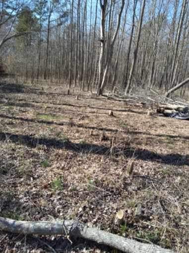

This is how the land looks. Not sure if I have a pic of the part that floods.
