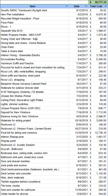

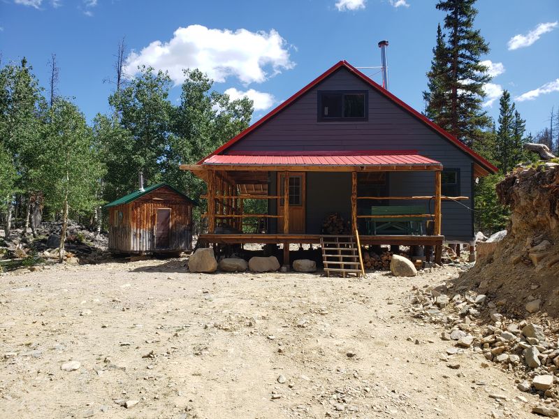

# Posted: 27 Jan 2022 02:31pm - Edited by: KelVarnsen
Nate, you and I are neck and neck for expenses. My spreadsheet is a bit more detailed. I've attached a picture of my reno purchases (Canadian dollars). I'm going to be working on my deck, a new outhouse, and a new bunkie this year, so it'll definitely be continuing.
Here's a post of some of the results.
Reno Expenses
Reno Expenses

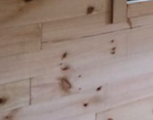

Are there butt-end splices in some of the long log runs? In one of the interior photos it appears there may be some. (photo section cropped and shown below) If there are butt splices how are those ends air sealed?

I should ask about those butt ends/splices and what, of anything between the tongue & groove run.
The chinking is a product called Log Jam; they have been using it for maybe 20ish years and 'say' No issues.
