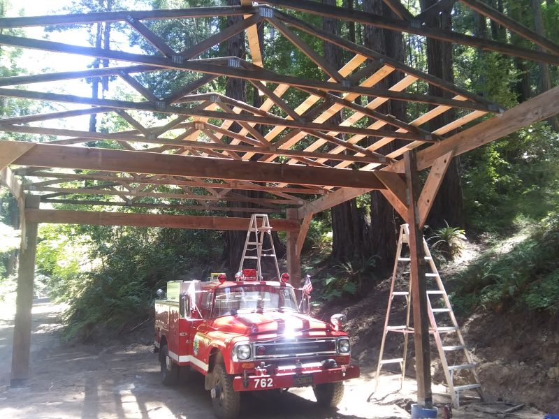

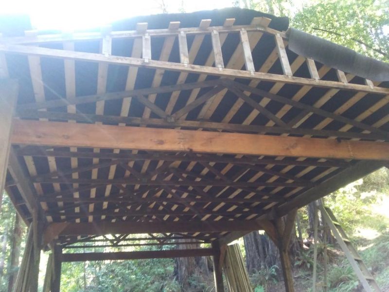

Along with my Darwin award quest, I have been figuring out my perlin spacing in conjunction with the holes already in the metal. Actually the diamond plate top of the truck bed makes a very stable ladder platform, more so than the 10' ladder on dirt.
Going to be about like this. My question is about the sides, do I run a perlin out to tip of the rafters, and how far do I overhang the metal past the rafters/perlin?

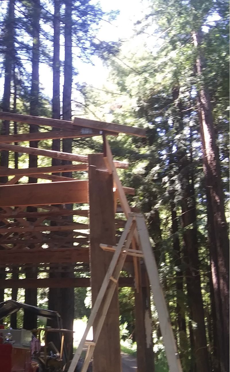

Funny you mention that.. can't really see in the photo but the rafters only go about 6" beyond the top rails. Total length is 11' per side. The panels I just cut in half are 12.5', and I have been grappling with either extending the rafters for perlins or cutting the panels down to 11'. Or, as you say, maybe they could just hang free that last 18". I'd really like that extra roof coverage.

Well it's time to cut my panels down to finish length, I just can't decide what that is. Hard to see in this photo, but the rafters extend 5" from the outside of the posts. And speaking of the posts, I am holding open the option to put possible put siding on it some day, sort of a pole barn.
I could put up a 1" fascia and cut the panels an inch past, for 7" total overhang. Or I could sister onto the rafters and go for 12" or more overhang. Any value to that, other than a bit more dry ground?

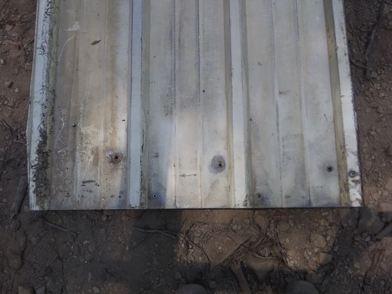

Working with recycled materials is a pain. It's satisfying not letting it go to waste but usually takes a bunch of extra time. So my panels have nice equally spaced existing holes for most of their length, which I have matched up to my perlin spacing, however one end have these mess of holes. Left long would give me 24" overhang but I would have to plug or seal the holes. Cut off that part gives me 18" overhang. Here's a test extension showing the 18" length.

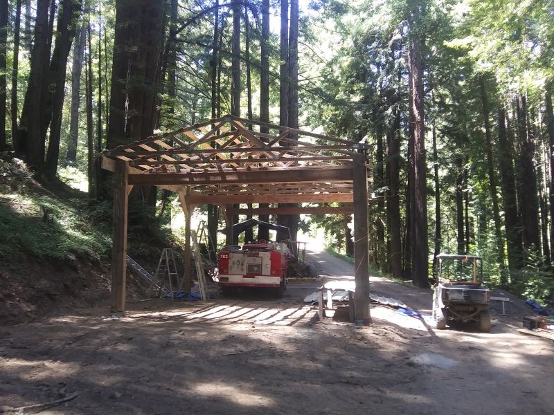

So I ended up extending the eves to 16" and cutting the bad holes off the end of the panels. Went ahead and put down roofing felt, mostly just to clean out the shed. Metal goes up tomorrow. I have not nailed down the end trusses yet, not sure how much to overhand the purlins, thinking maybe 2-3 inches.
