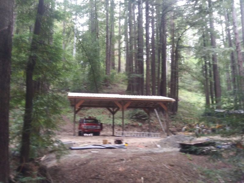

Painted the carport roof yesterday, white was too bright, plus should seal up any potential screw leaks. Time to think about the ground, just dirt right now. I was thinking of using the last of my pavers, probably have just enough. Another massive task. Then I got to thinking asphalt grindings might be better. I get them free but have to haul them in, still easier than pavers. They tamp down pretty well. Other option is a slab, 4 or 5 inches thick. 32x20, probably looking at $5K to get the truck here? What would you do?

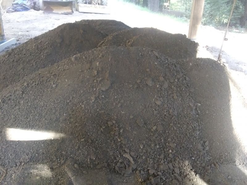

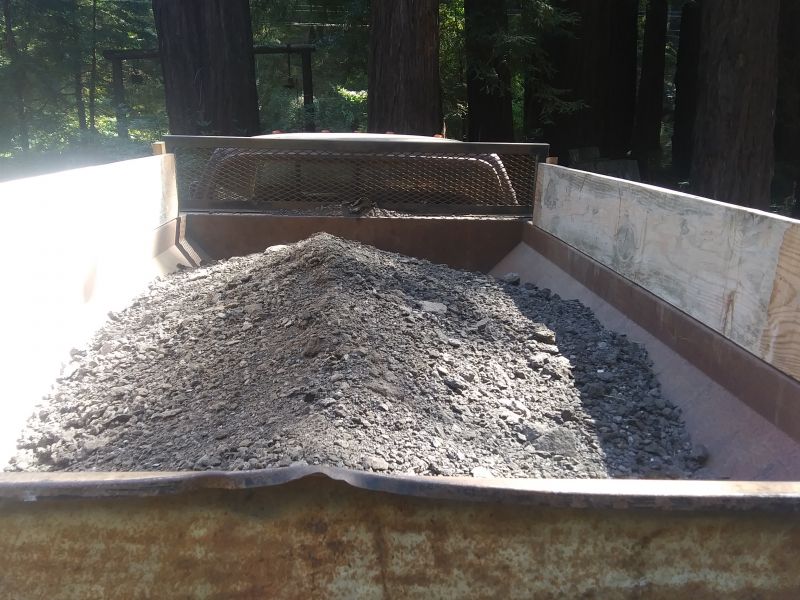

Monday I made 4 trips to the county asphalt grindings mountain for free stuff. Best part was a county guy hopped on a loader and even waited there while I made the runs. Come back any time.. I could use about 2 acres!
So I'm doing final grading now before I lay it down

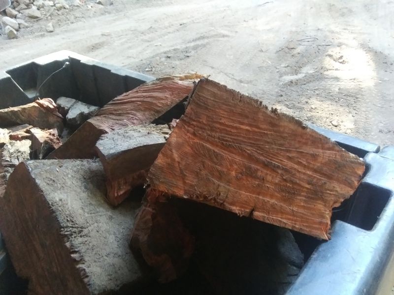

Well I think I have enough asphalt grindings now, lol. I spent the last couple of days knocking down a 3' stump I thought I had ground low enough but wasn't. Two chainsaw chains, a sawzall and a circular saw blade, sledge, pick ax, wedges, pry bars and a lot of sweat later, I'm ready to spread and tamp next week. That stump wood is like iron.
