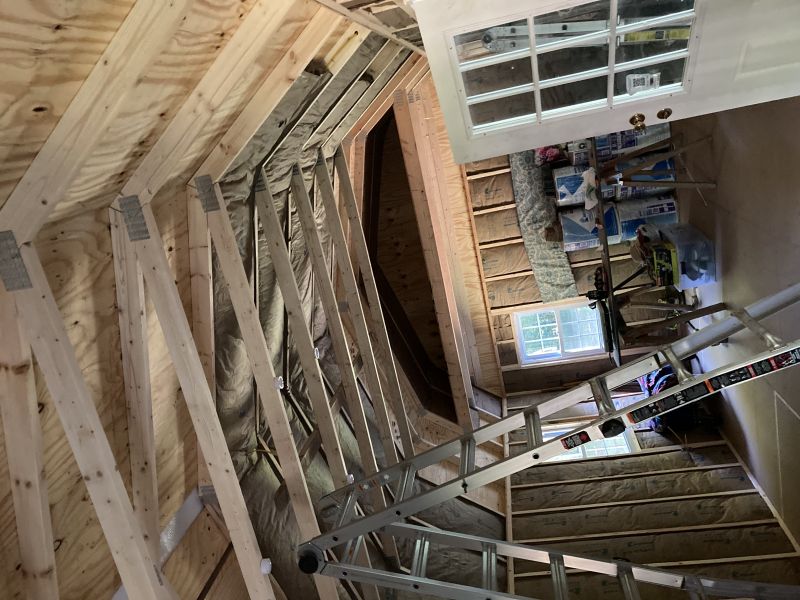

I’m brand new to this forum but I’ve been stalking for a while now. My shabin has arrived and I’m working on getting insulation installed bc I’m in Indiana so we have hot AND cold so I’m not 100% sure how to do my ceilings with respect to moisture accumulation. I have a metal roof (no ridge vent) with underlayment then OSB. I am making the ceiling vaulted. I will likely stain my trusses to make them look good. I’m installing insulation with kraft facing. Since the ceiling is essentially unvented I suspect I need an actual air barrier overtop my insulation or beneath tongue and groove paneling that I will eventually put on? I have a wood stove for heat and a small window ac unit for summer. I have read when to use a vapor vs air barrier guides on the web but they are typically talking about a normal house roof with an attic. In this particular application I’m not sure how to proceed. Do any of you have suggestions how to do this without creating a moisture situation in my walls and/or ceiling? I’m attaching a photo to give you a better idea of what I’m working with.

As mentioned, closed cell spray foam is a great option if your budget allows (and might not be as expensive as you think).
We did ours this way and added in spraying the loft end walls (I had already insulated the rest). No venting or vapor barrier to worry about plus really good insulation both summer and winter. Not to mention the professionals will have it done in no time.
# Posted: 15 Jul 2022 07:02am
You will never get enough insulation nor enough air sealing with batt insulation for that ceiling. It's not really about how much heat loss/gain your going to have..air will leak out and meet a cold piece of plywood and cause condensation. Condensation in a enclosed space will mold.
Theres really just no cheap way to insulate a 2x4 truss vaulted ceiling, or even a 2x6-8 vaulted ceiling for that matter.
GrapevineVilla
# Posted: 15 Jul 2022 07:44am
One reason I didn’t use foam boards with spray around the edges was it seemed like it was hard to get a good R Value? I’m not opposed to taking the batts out of the ceiling and using foam board if it means my cabin will last longer. What R value have you all been using when you use foam board insulation?

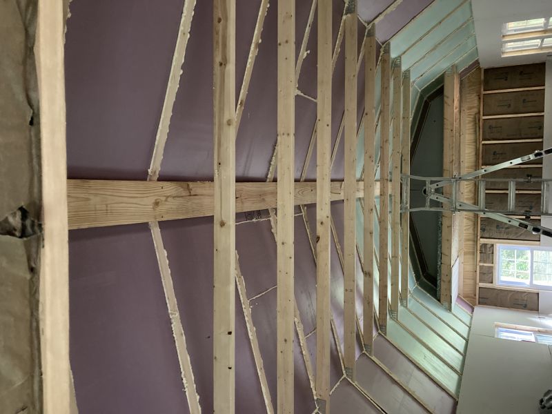

# Posted: 25 Sep 2022 08:31pm
Decided to go with two inch foam board with a half inch air space beneath. This has made a massive difference during the hot weather. Now… I have a small wood stove to try and figure out how to install. My main challenge so far has been figuring out the flashing on my metal roof. I see a lot of silicone boots being used. Does anyone have experiences with these? Good? Bad?

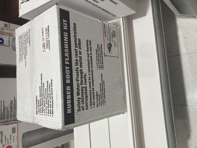

I checked the price of those silicone boots a Menards today and about had a heart attack. It was $199.99 for a kit. Does this kit seem expensive for what you get?

Roof boot
This is like what I have, unsure of the temp range on mine vs. what I linked though. I have no idea what all is in that box, but the boot alone was all I needed.
But to answer your question with only my opinion, yes.
