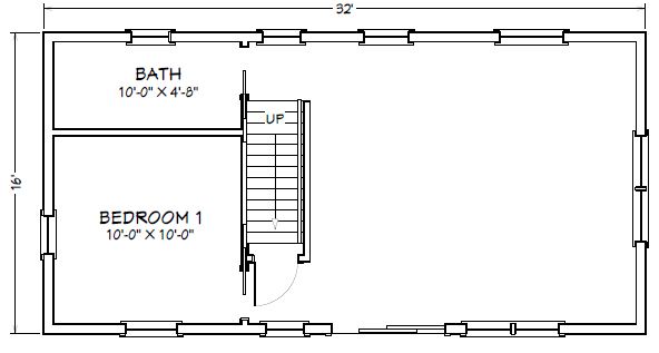

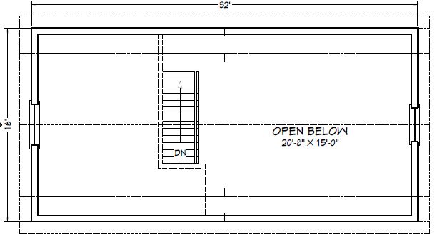

The part i've been struggling with for the interior is the stairs going to the loft. Somehow, somewhere i messed up with calculations that the stairs would fit in the location shown in the 2 attached photos. Even with the bedroom and bathroom doors as close to the exterior walls as possible, the run plus rise of the stairs to get to the 106in high loft floor is not possible in that space between those two doors...plus still leaving enough height at the landing. This is obviously following things to code which is min. 9in tread depth, max 8in riser height, 36in tread width and having 74in of headroom for 3ft in front of and at the end of the stair run.
Now i could play the "it's for storage only" card in regards to the loft, but i'm not sure i want to pull that card just yet. So i'm playing around with two different u-shaped stair patterns as well as a spiral staircase. Both have serious impacts on the kitchen space and the entry space. I don't want to mess with the bedroom and bathroom layouts as i like how that wall will end flush with the edge of the loft. Maybe i'll post some photos of the layouts and get ya'lls feedback.

i hope someone else has a brainstorm for you because 'i got nuthin', i have no experience with building, yet!
thanks for the floorplan pics. what are you doing for a kitchen? i'm grappling with expanding my project to 20' or 22 foot wide - i didnt realize how limiting 16' is in terms of the size of rooms you can have, plus its pretty much impossible to have a hallway of any sort, so like you, you just have to jam everything into the end of the structure. This leads me to thinking that i'll have to have a loft, so have to grapple with how that will impact the plan, budget, etc. So many 'regrets' videos talk about how they should have made it bigger from day one, so i dont want to make that mistake!

Your site and wallet will determine what you can do for sure!
The only reason my cabin is this big is due to finding a happy medium of what i wanted and what the wife wants. The easy solution would be putting the main bedroom up in the loft and either making it bigger doing a second loft on the other end (one of my original ideas). The other fix is a ladder vs. stairs, but that's a no go for a few reasons for us, primarily being the dogs getting up to the loft to be by my son. The other pain point for me now is all the windows are in so i'm locked into that, thus preventing me from shifting the stairs to a wall.
One thing i'm learning about designing floorplans is think about consolidating as many shared dead spaces as possible. Example in my layout i just posted is that i had the front door, bedroom door and closet doors all in the same area. So instead of having 3 unique dead spaces for each of these door swings, closet access, bedroom entry they were consolidate into one.
