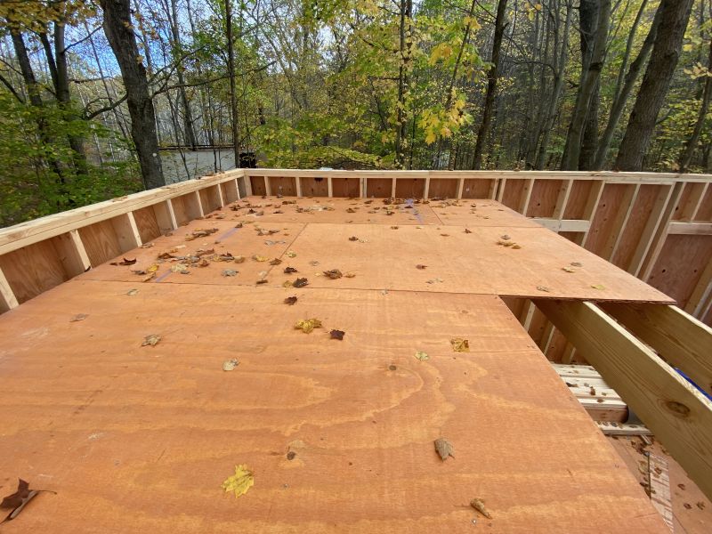

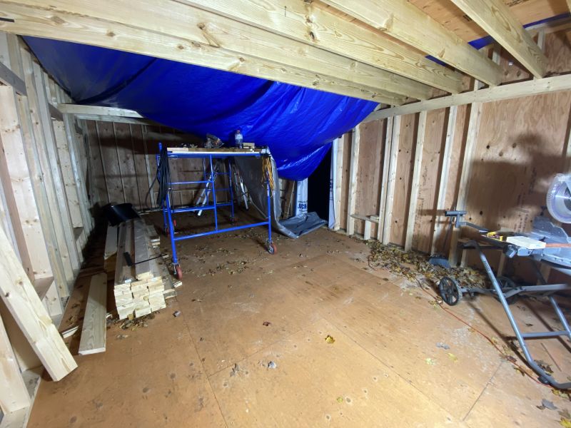

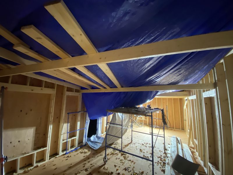

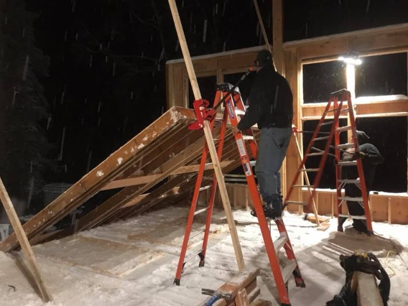

Well, made it back up late this morning. Was foggy all day, then cleared up nicely, then rain was coming. Manged to get the loft joist in and some of the subfloor done up there. Wasn’t planning to do all the loft so I’m short 2 sheets, will have to finish it later. Figure the loft will make life a little easier setting the first couple sets of rafter assemblies.
Supposed to rain tomorrow again, so I went a bit overboard with a water shedding tarp system. This way I can work inside the cabin building rafter assemblies. Also decided to use the wall instead of the floor to save my back when building them up!

When tarping over Ive found I need at least twice as many supports as it initially looks like, and steeper pitch to run the water off rather than sag, puddle and fill.
Oh, says I, I'll just push the sag puddle up and it will all run out. It rarely works that way, sag puddles dont 'push'.

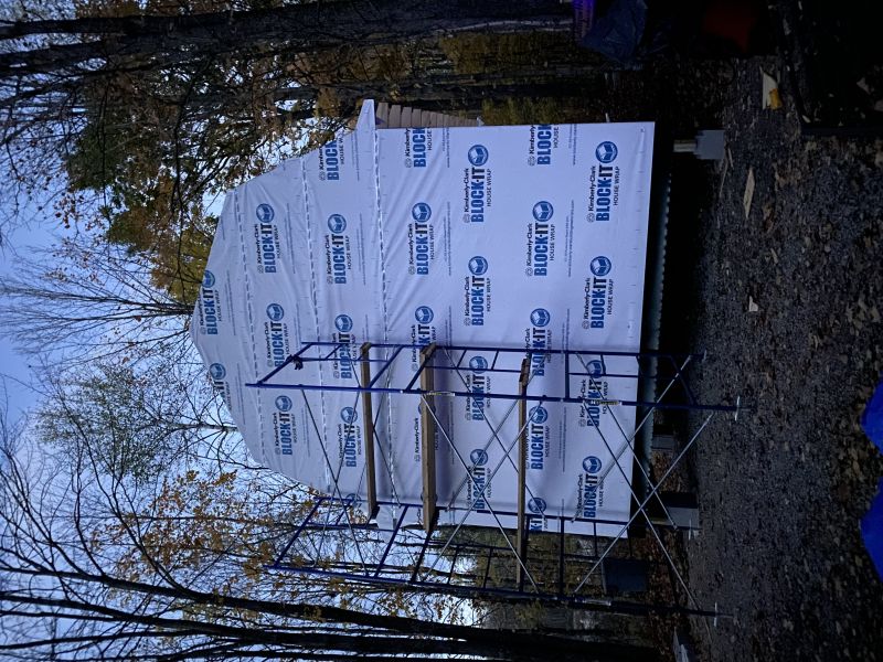

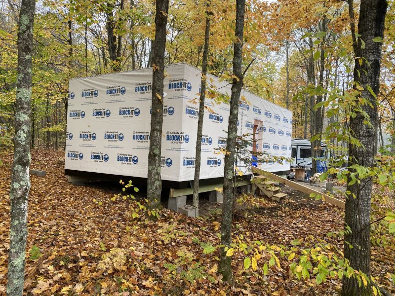

# Posted: 12 Oct 2021 09:47pm

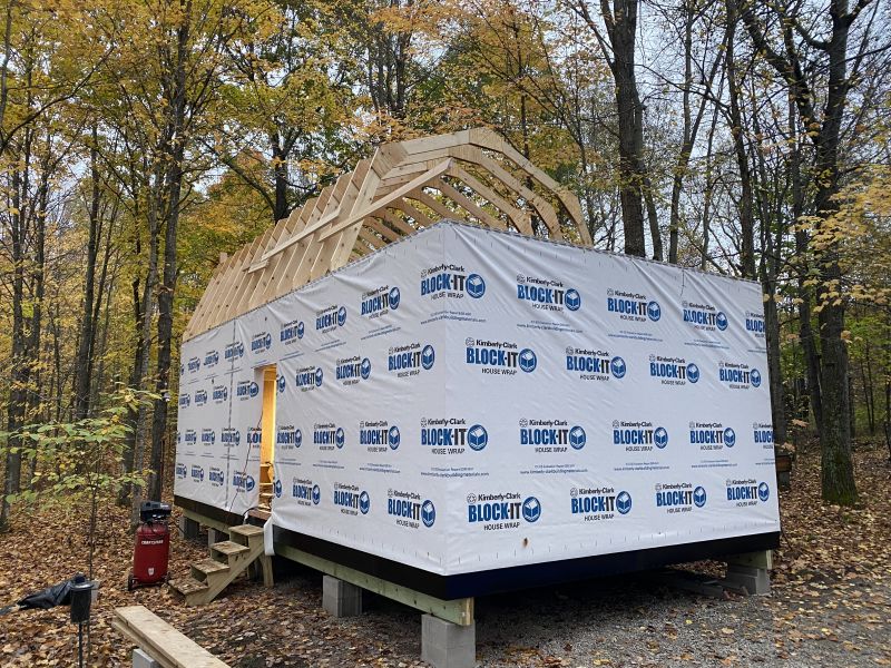

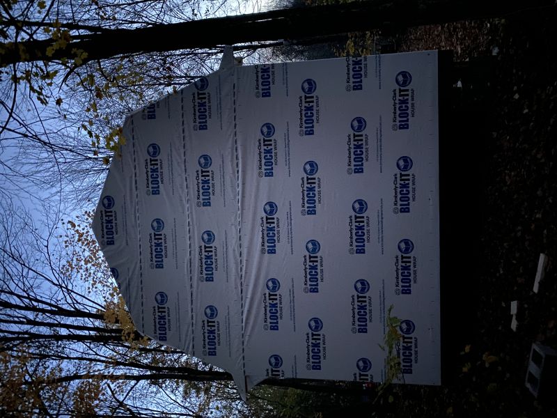

I got the gable ends sheathed and wrapped today.
Found a guy that’ll supposedly sheath and paper the roof for $1k on Monday. I don’t know that I’m in the position to be picky right now but is that even a decent price?
Nate R
# Posted: 12 Oct 2021 10:05pm
When I think about sheathing my roof, and then the added difficulty of yours....yeah, I'd say that's about right. I mean, I'd gladly pay that if I were in your shoes.

# Posted: 14 Oct 2021 12:09pm
Well i officially called it quits up there yesterday. Between the arthritis in my hands and my uneasiness about the heights i couldn't keep going. So i've got the professional guy coming on Monday to put the fascia boards on, sheathing and ice/water barrier & 30# felt. Per my neighbor he said the guy built one of the camps on our road, so he's known in the area.
Now i just gotta hope my rafter assemblies are good enough for him to work with.
