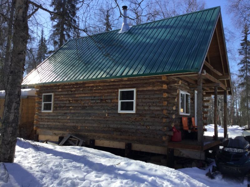

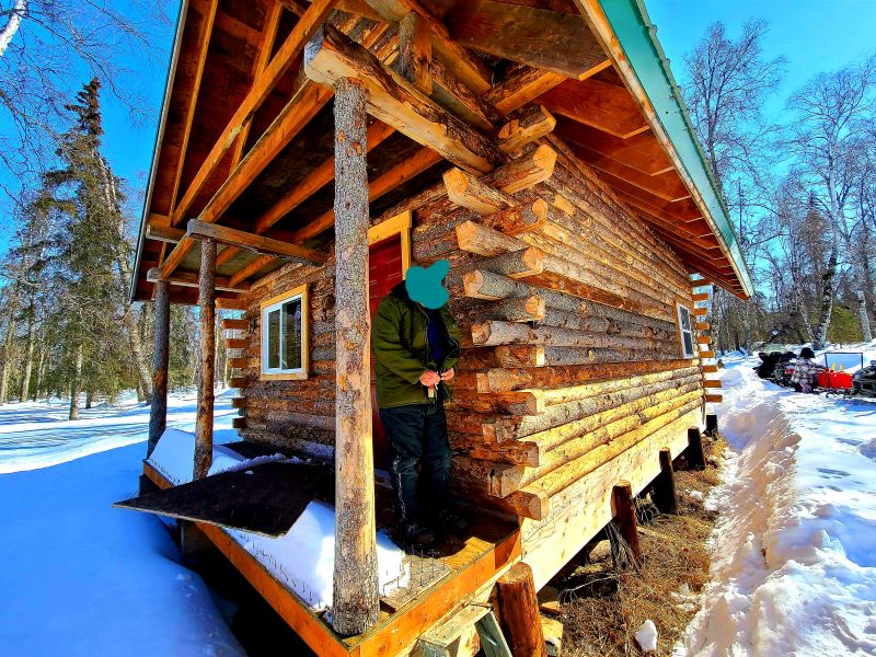

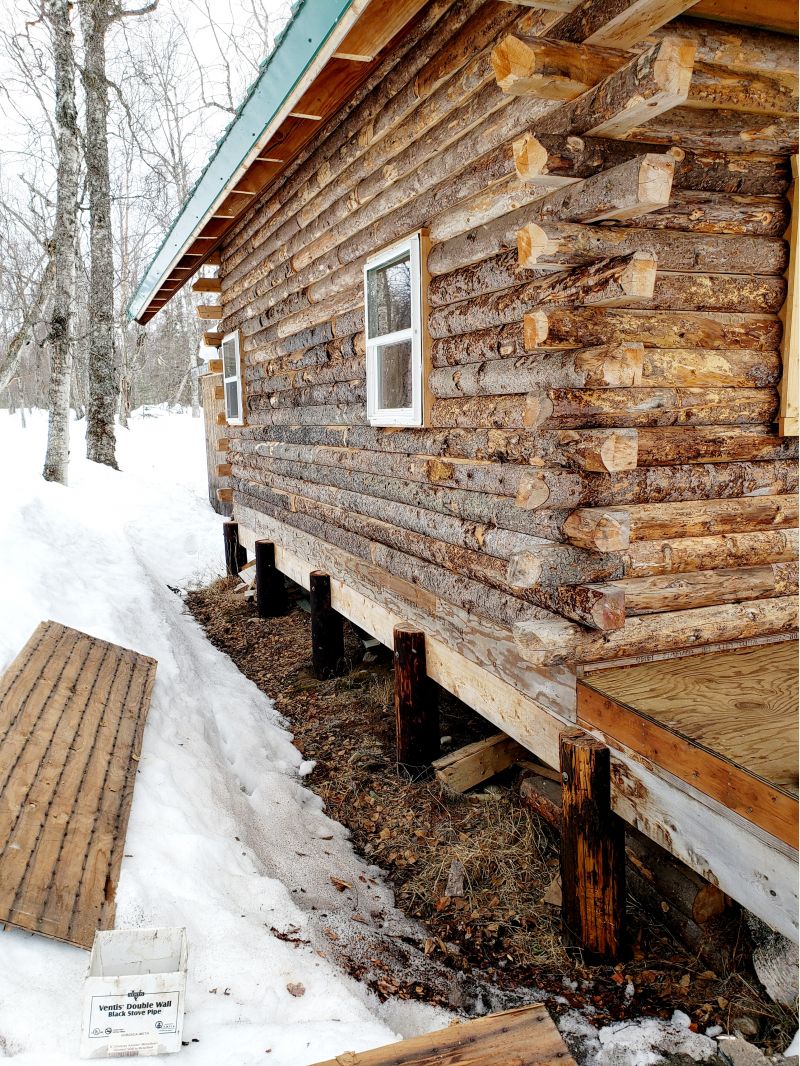

Welcome TN. Sounds like you got bit by the bug n have cabin fever. I used cedar utility poles for our cabin. They are doing great. I got mine for a good price as they are replacing some along a new road construction. Get them out of the way.
Cedar has a natural oil in it that resists rot. Will last a long time. Real easy to cut off level. We cut a shoulder into the top to hold the support beams. Good solid floor that doesn't frost heave the pilings. We built a 16x24. And put 3 rows of pilings in. If you can keep the water away by adequate drainage around your pilings and cabin. It's been tested by 7.2 earthquakes and 14' of snowfall.
Good luck n stay positive. You'll read n hear plenty of advice, good n not so much. I can say that this system works very good and we have a solid floor when it's walked on.
We're remote n miles from any roads so have to use snogos to freight our building materials in. Using the cedar poles worked great.
Pilings under cabin
Pilings under cabin
Side view
Side view
Front
Front
Heaven to a woodsman

I love your cabin - TY for sharing the pictures! I'm a very visual person and am always lurking around for pictures for ideas and to get a better idea how to design stuff!
I hadn't considered a foundation setup like yours, I could possibly take that setup (but with 6x6's and coated with tar as others noted above) and utilize it in a similar way to the concrete pier setup I noted above? It just irks me spending over $1,000 on cardboard tubes and small pieces of flimsy metal lol

Would you mind sharing details on how your pilings are installed (and/or pictures lol)? If not that is fine too I saw a couple of reference images online of something that I think is similar to your setup - they had a concrete 'cookie' at the bottom below the frost line, 6x6 post setup on the cookie, backfill to ground, beams connected (sitting on a notch with a bolt/nut ran through it) to the 6x6 and then floor joists on the beams. - Sounds similar to the concrete pier setup, but utilizing a concrete footing with a backfill 6x6 post instead of a large concrete pier.
