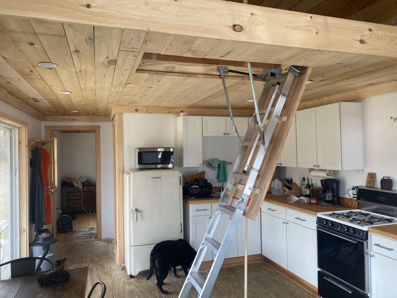

Not sure it would work for you but this was my solution for loft stairs.

IG, I like the attic ladder but I don't think that will work for me.

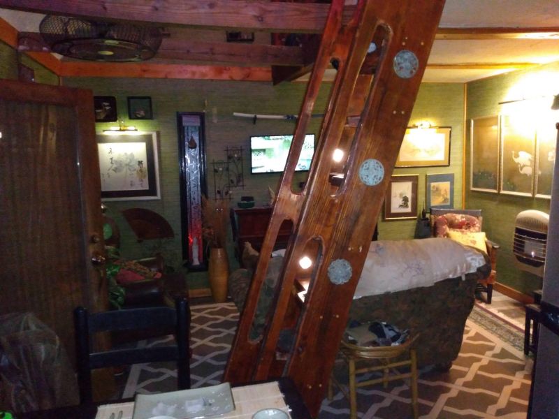

# Posted: 25 Sep 2022 11:29pm - Edited by: Kaznats

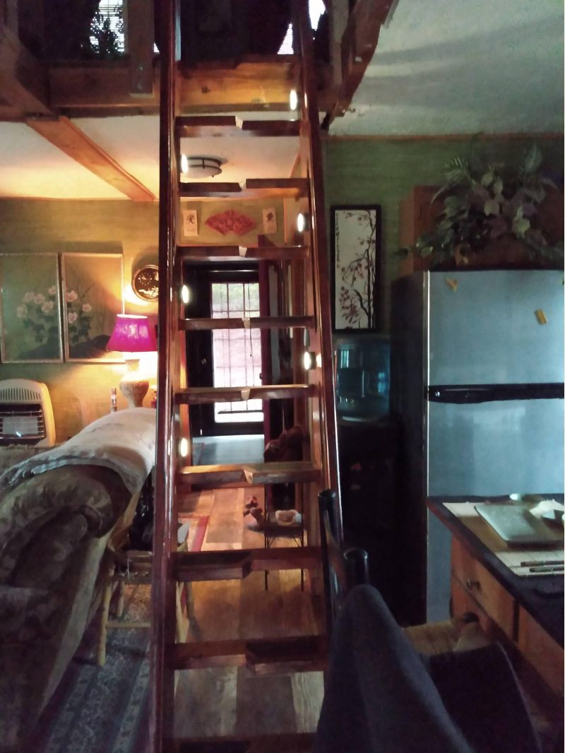

may I suggest you build a ship's ladder with alternating tread:
https://www.youtube.com/watch?v=yaOngzL4vNQ
I built one for my 16x20 cabin that has a loft and I couldn't be happier with it and I'm nearly 70 years old.
alternating tread
alternating tread
ship's ladder
ship's ladder
Link44
# Posted: 26 Sep 2022 08:57am
Kaznats, that is a beautiful ladder. I am considering a ship ladder. Has it been used by younger children and how well did it work for them?
Thanks
Kaznats
# Posted: 26 Sep 2022 09:29am - Edited by: Kaznats
Thanks. It only cost me about $120 to build and I can easily go up and down it even using no hands. I doubt it is safe for very young children but I have a friend who has severe MS with kyphosis and she was able to go up and down the stairs (okay I had to give her a boost from behind but as I said we are friends). Check out the links for the safety of alternating tread stairs for children to determine if it’s suitable for your particular needs but in my experience adults have no problem using alternating tread stairs once they overcome the fear of heights. The hand rails provide plenty of safety and I’m not sure if it shows, but I even built a cage at the top using black iron pipe to add extra safety when beginning the initial descent.

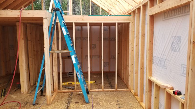

Brettny, a little of both. I planned for the stairs to be there with a landing at the bottom against the right side wall so you could turn left and head up. They are looking steeper than I was wanting in real life vs paper so I'm trying to modify on the fly. I did plan for the stairs to rise with the rise of the gable roof. The loft is just barely 72inches at the peak.
I have room for a step before the landing and not have it in front of a window and was thinking about having the landing be a winder with 2 steps to lessen the angle.

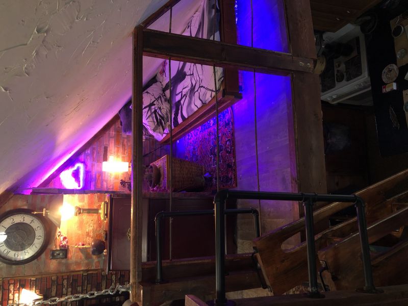

# Posted: 27 Sep 2022 09:10am

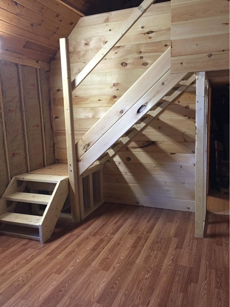

I had a similar amount of space. I turned the stairs in the corner.
# Posted: 27 Sep 2022 09:37am
Those look great!
Dont guess use a stair tread calculator. Theres a calculator for everything now.
Link44
# Posted: 27 Sep 2022 06:14pm
Those look close to what I need. What kind of rise and run did you have? Are they easy to come down facing forward?

Thelar
# Posted: 28 Sep 2022 10:06am - Edited by: Thelar
I built those almost 10 years ago. I think the rise is 8", run to the wall is 104', platform is 24" wide, run down to platform is 80". 8 stair treads are 10". Platform is 24" high. Rise is 8", run is 30". 3 stair treads are 10".
I used this product which are not sold any longer. I didn't have any experience cutting stringers.
https://www.jlconline.com/products/ez-stairs-makes-stair-bulding-faster_o
The stairs are easy to come down. It looks like your stair space is smaller. You can build the platform higher, so the stairs are not so steep, or turn them 180*.
I have never been to Oregon. I imagine it is similar to Maine. Love the Rangley area. We are north of Bangor in Lincoln.

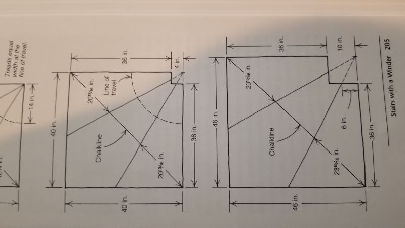

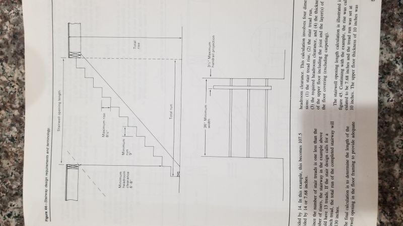

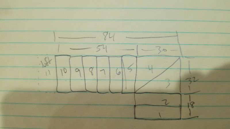

I have read books that stretched the stair dimensions from 8.25/9 to 7/11 rise/run. Of course my favorite is the book that aligns with my space requirements .
My father in law loaned his United States Department of Agriculture Wood-Frame Construction book revised 1989. It had the spec of 8.25in rise with a 9in run. I can barely conform to this with my space I have allowed for the stairs.
ICC, what is your feeling of alternating tread stairs?
This is a very quick sketch of the idea.
# Posted: 3 Oct 2022 08:10pm
7/11 rise/run sounds alot better. Why the different tread width above and below the landing?

Link44
# Posted: 3 Oct 2022 10:39pm
I have been thinking about how to have a hand rail on both side. The inside is easy since there is a wall right there. A short post, for the hand rail to land on, cut into the corner of the winder would force the path of travel to the wider part of the step. I found some examples, not my dimensions but visual aid anyway.
I drew on the cabin floor the layout for the winder. I was trying to envision using the winder and it seemed like I had 2 left feet.
