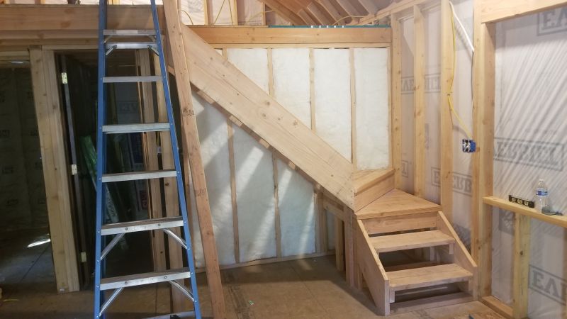

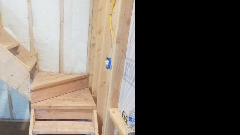

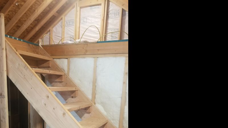

I wanted to share the end product of my stairs. My father in law was a huge help this last weekend and we built the stairs. They came out 8in rise, 9in run with the winder landing and they feel good going up and down.
I am working on ideas for a railing next.

Posted: 14 Jun 2023 07:32am
The middle pic has an optical illusion, sure looks like a 'stairs to nowhere'; lol.
