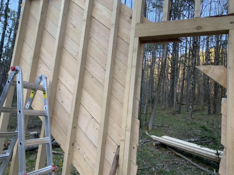

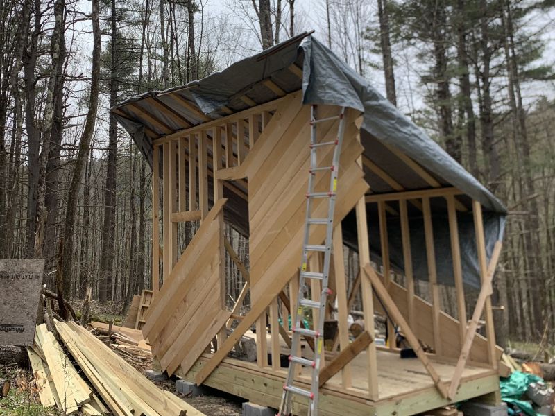

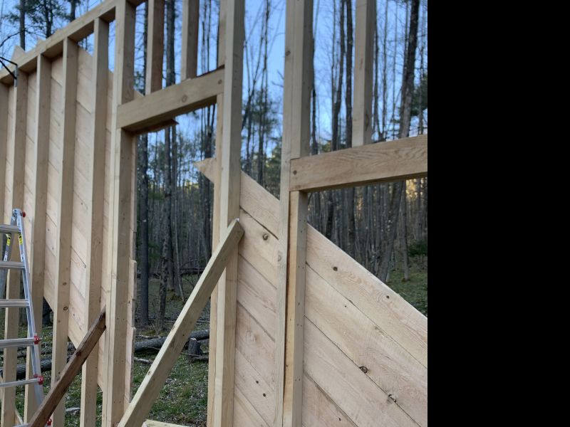

I'll add a couple pictures of what I've gotten done so far.
