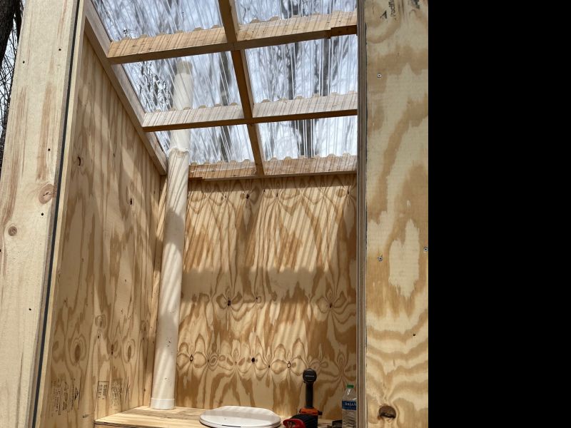

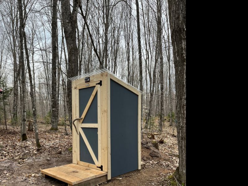

I finished the outhouse on my property a couple weekends ago, and am having a couple minor issues I wanted to ask about.
1. I used 4" PVC from the seat thru the clear corrugated roof for a vent pipe. I was able to cut & trim the hole fairly close to the OD of the pipe before using clear silicone to seal it, but i notice rain still pools up in the "valley" and will slowly drip in. What would be the best way to seal around the vent pipe thru the clear roof? Use a flashing boot as if it were a steel roof?
2. I used plastic closure strips from the same manufacturer along the purlins. I drilled holes for each screw and used the roofing screws with the rubber washer in the peaks not the valleys. On a few of them, water will slowly drip in during a heavy rain. Is it worse to get the screws too tight or too loose?

Could you re-work the vent pipe location outside the outhouse to avoid the roof penetration? A couple elbows would do the trick.
# Posted: 10 May 2024 12:34pm
I would also buy a new piece of roofing and send the pipe up outside of the roof. In the end its going to be cheaper than a proper EPDM roof boot. Your roof boot also needs to be screwed to wood every 1in.

Thanks, all. I think I’m going to end up going out the wall and up on the outside…either keeping the existing outlet on the seat board or going out the back of the box. I tried asking for input on that a month or so ago, but all I got was answers to questions I didn’t ask.
Fewest bends would be best

If ya just gotta go out the wall use two 45 degree bends rather that two 90 degree; the uprise will help keep the air moving whereas a horizontal run will slow it.

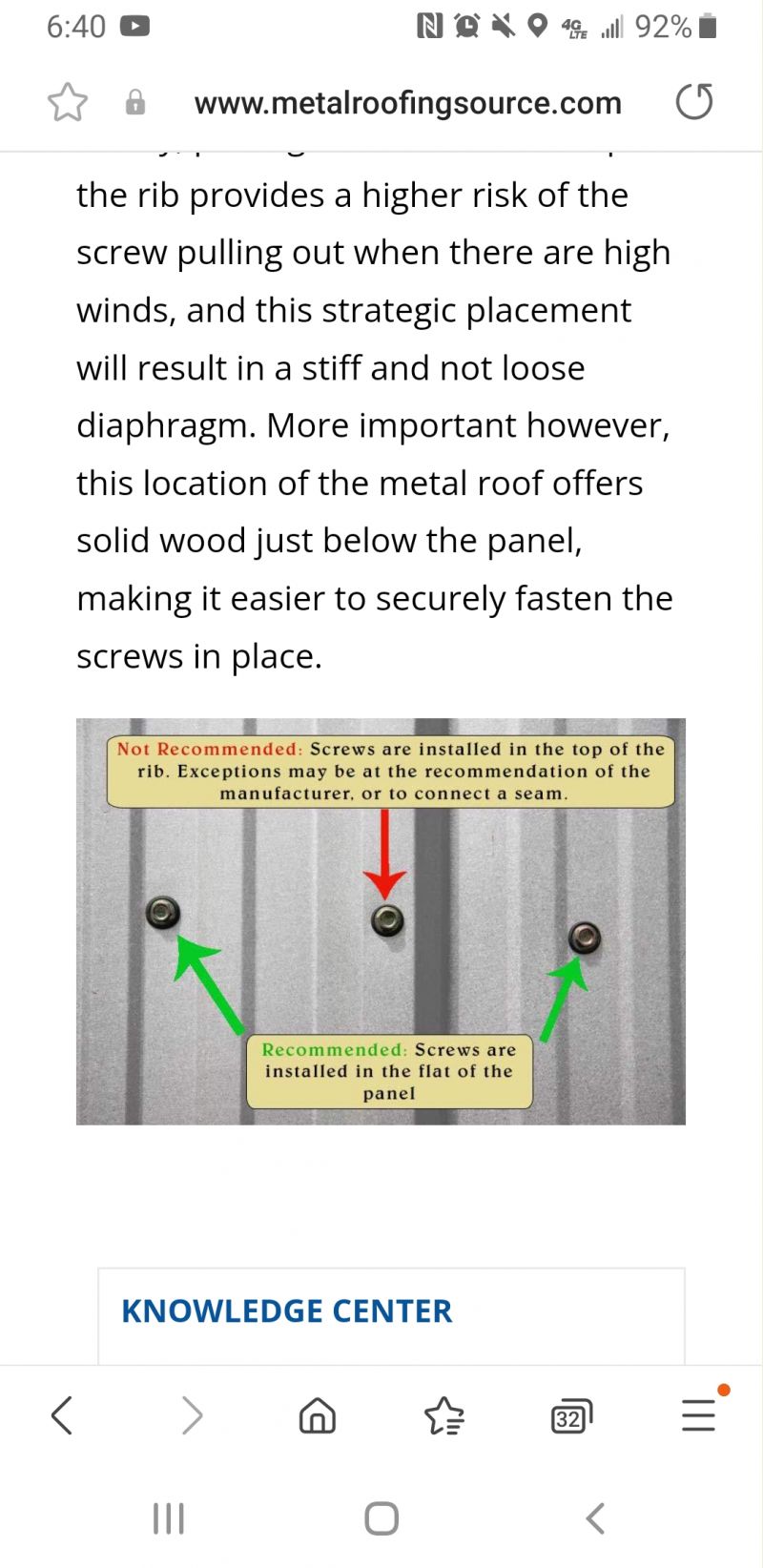

Quoting: IcutMetl
I screwed on the peaks, and not the valleys
I think your going to find your self replacing the whole roof. Not even metal manufacturers suggest putting screws in the peak of the rib. It distorts the metal alot and you end up with a wony roof, you also need a fair amount of pressure on the sealing washers in metal too. Plastic moves even more and wont allow for a good seal.
I remember your thread asking about the through the roof vent. You didnt mention it was going to be a poly roof. The issue on how to seal it may have come up if it was.
You referenced my other topic and said I never mentioned it being a poly roof- look at post #9. https://www.small-cabin.com/forum/3_12080_0.html#msg167402
You also mentioned that manufacturers don’t recommend putting screws in the peaks- that is false…plenty do, both metal and polycarbonate and there’s plenty of information to support either option for both materials. See page 8 of the installation instructions for the polycarbonate roofing I purchased.

Quoting: IcutMetl
Yup... I installed metal roofing from Ideal Roofing on the garage around 15 years ago... they recommend putting the screws in the peak, so I did... no problems. Ditto on the house, which we did ~5 years ago. I have no experience with plastic roofing, though.+is

They expect you to put a closure strip at every perlin? That's kind of laughable.
I wouldnt put them in the ribs. Theres just really no benefit of it. The water can go around a screw in the flat just like it can roll off the top of the rib.
