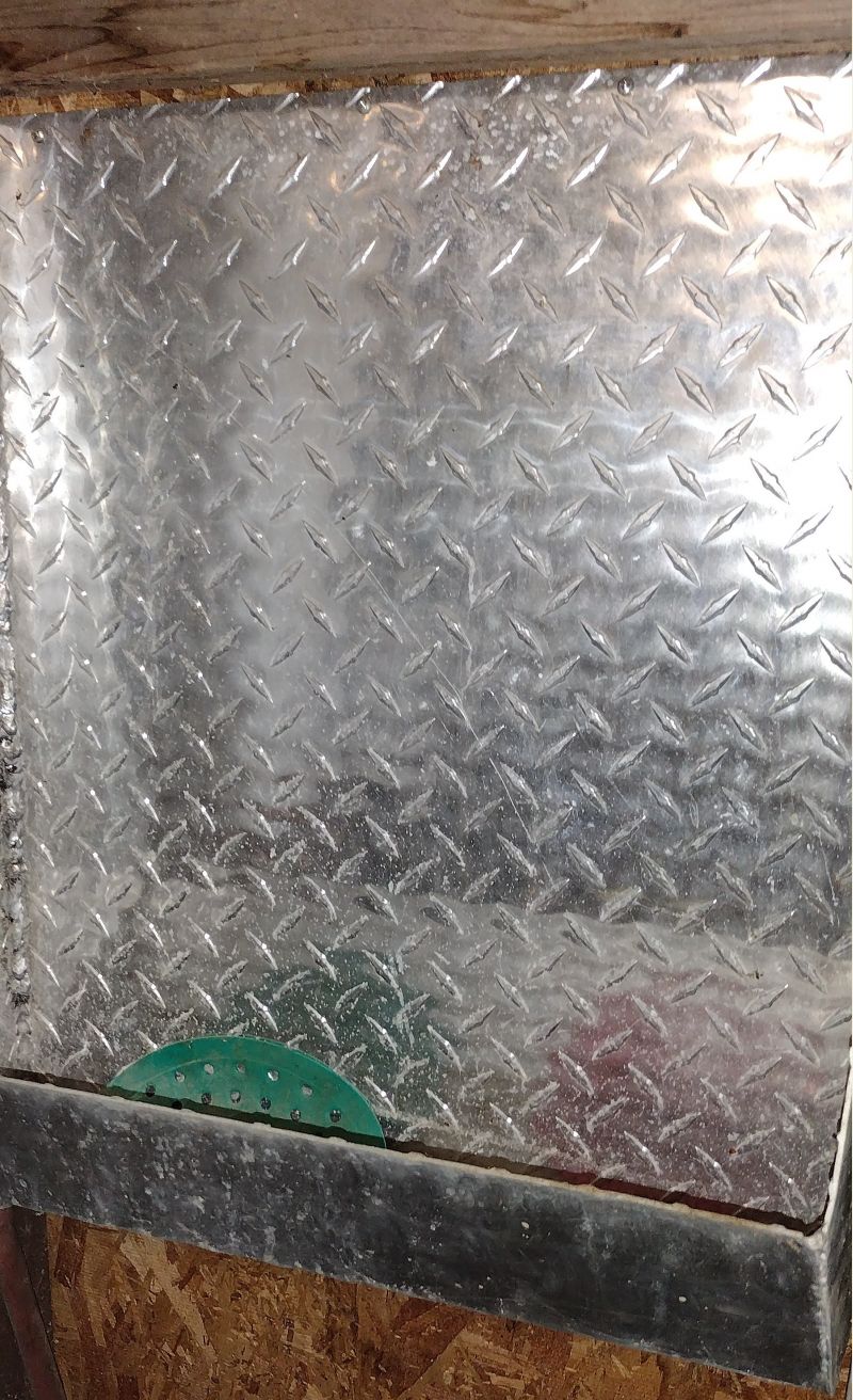

On ours. I cut the bottom out of a 55 gal plastic barrel. Buried it deep enough to where the top was at a comfortable sitting height. Then built the outhouse around it.
I cut a 4 inch hole out the backside, thru the wall and in the barrel about a foot above the ground.
I used cheap dryer vent pipe, and ran the stack above the roof line with a rain cap. So, out the back with a 90° elbow, then up.
It provides a slight down draft on the throne, then up and out. Also I fabbed a stand up urinal that goes through a garden hose, into a small gravel filled hole. Not in the pit.
If you don't throw TP in the pit, the solids will break down easily. About once a year, I mix regular yeast with warm water, and pour it in the pit with a 2 gallon flower sprinkler.
I've never had to dig out the pit, only had to pick out the occasional TP, when someone doesn't read the sign on the wall, right in front of them.

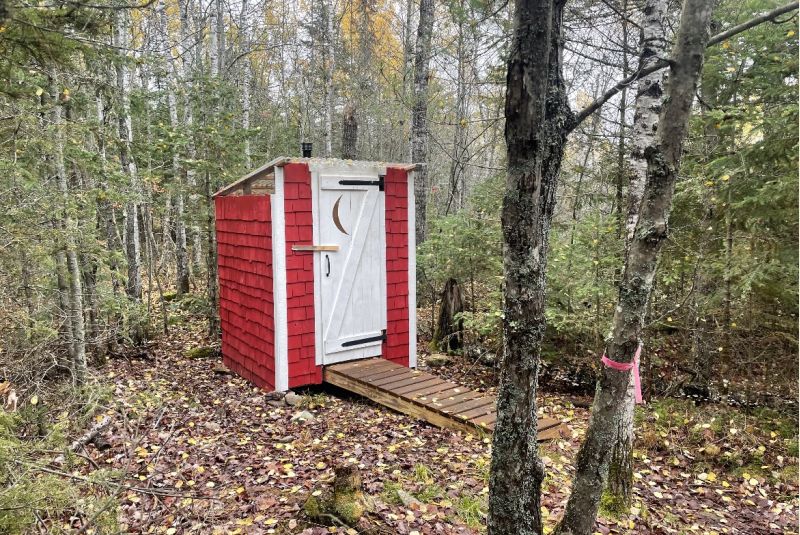

My set up is a holding tank rather than pit because the state won’t let me install over a pit even though I’m 100 yards from the lake and 50 ft above it… I cross vented the tank and vented the pipe out of the back of the outhouse and up the back wall. I also have Clear roof as well.
I will however second the urine diverter. I will be installing one first thing this year. When it was just men using the outhouse mainly for a year while building there was almost zero smell. When the girls started using the cabin more, the smell has gotten to be pretty bad at times. Ive learned that It’s the liquid waste that carries most of the noxious smell. We’ve tried lime and a lot of the other suggestions to no avail. I imagine my setup is particularily bad for liquids since there is no way to drain them into the ground like in a pit. Aside from the diverter, I will be dumping in chemicals this year similar to a porta- potty to try and cut it down.
Here’s my privy. I couldn’t find any picture of the back unfortunately.

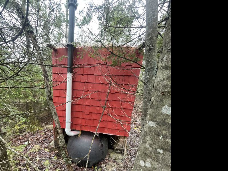

# Posted: 28 Apr 2024 11:21pm
Was able to get a photo of the venting on my setup. This passed inspection. I asked the inspector and he said it didn’t matter as long as it had somewhere to vent.
