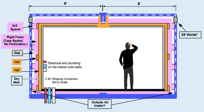

The aim of this build is to have a continuous gap between the rigid foam board insulation (Tape Sealed. No Perforation) and the corrugated wall,
allowing cool or ambient air to circulate and vent
outside to prevent condensation during the winter, and excessive heat in the summer.
Should that air be coming from the outside?
Thanks!

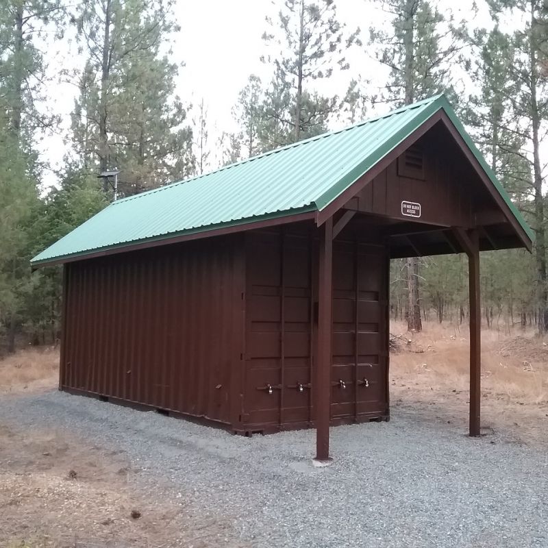

I'd use closed cell spray on foam in the air space.
I installed a container and added vents, 3 low on one side, 3 high on the other and put a roof on it with an attic and vented at gable ends and vents in every rafter block, it is free of any moisture and stays cool even on hot days. I have no insulation on the inside. Its just for storage.

That was the part of my plan which I was confident about. Take a look at the illustration in the initial post.

Why would you not take ventilation air from the outside? The alternative would be air from the interior space. For many months of the year, the interior air will be conditioned, cooled, or heated. Moving that out through the wall ventilation would require that air be replaced with exterior air and reconditioned. A waste of energy, no?
I am very curious why spray foam is "out of the question" while rigid foam panels are okay. I can understand some people not liking foam at all, from an environmental aspect. If that is the case what type of foam sheets are you thinking of? Some of the newer foams (rigid sheet and spray) use newer blowing agents that have a reduced carbon footprint. Then there is also polyiso foam which is even better. More on that later.
I have serious doubts about how effective your proposed ventilation of the wall cavity would be. For one thing, I doubt there would be any meaningful ventilation of the ceiling space. The air would tend to just sit there in the horizontal space. The air in the wall space could rise as it warmed and vent out the top vents. I wonder how much air movement and moisture removal there would be on a cool day. Possibly this could work better with a forced air ventilation, but that needs energy.
