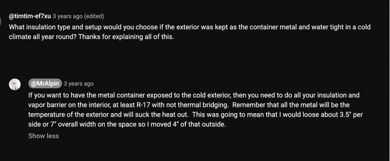

# Posted: 14 May 2025 02:43pm
If you insulate the outside of the container it will become part of the moderated temp heat/cold sink; that would be a good thing I think.
But...at one time when containers were 'cheap' it might have made sense, now with the higher cost and delivery I'd have to do the math against a similar size stick built done the Right Way, Right Off.

# Posted: 15 May 2025 10:00am
Very interesting read!
"One of suggested solutions proposed by people knowledgeable in the matter is to leave an air gap between the container’s metal walls and the layer of thermal insulation. In this case, we accept the fact that the vapor this or other way will migrate towards container’s walls and when outdoor temperatures and the level of indoor vapor create conditions for condensation, it will take place.
The ventilated air gap in the condensation zone allows for evacuation of moisture and vapor to outdoors, significantly limiting the potentially disastrous impact of trapped in the wall water on the structure and health.
However, if the air gap is properly ventilated, it will offer a sort of “open-doors” for continuous evacuation of the moisture outdoors. For sure, the adequate ventilation is the key parameter of this protection system. It must be designed for that purpose and most likely “assisted”. In other words, the natural (passive) ventilation based on convection may not be efficient enough. Depending on location (climate zones) you may need either roof-mounted wind-propelled turbines helping to move air, moisture and vapor across mentioned air-gaps or even strategically located, small electrical ventilators.
It seems that the air gap of about 1-to-1.5” (2.5-to-3.5cm) thick may be enough to guarantee efficient airflow. While this extra 1+ inch will have an impact on the overall thickness of the wall (and free indoor living space), it may be still a low-cost solution to the condensation problem."
