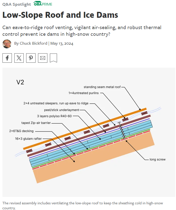

# Posted: 14 Jun 2025 11:31am
Check out Green Building Advisor and search low slope roof vented above deck. Lots of info on vented and non vented systems.
Vented roof deck
Vented roof deck
# Posted: 14 Jun 2025 11:48am - Edited by: gcrank1
That pic looks like what I had in mind if I had built my own this last time, though for an essentially 3 season 'hunting & fishing recreational' cabin here I would not have had to use as much insulation.
