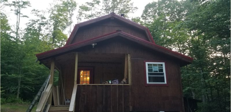

We are at roughly $26k. I did everything my self with the help of friends and family. This price includes the foundation, R21 walls, R42 ceiling, R21 floor, all interior finishes, the windows and doors along with the solar system and mini split
I bought most of the materials from auction houses and Facebook marketplace. I think I spent less than $5k at big box stores.
One thing I can say is buy your windows and doors before your plan is even complete. Windows get expensive when you have to buy a specific size. Those large windows are 3'x6' there new low e argon filled and I paid $125 each.

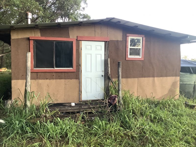

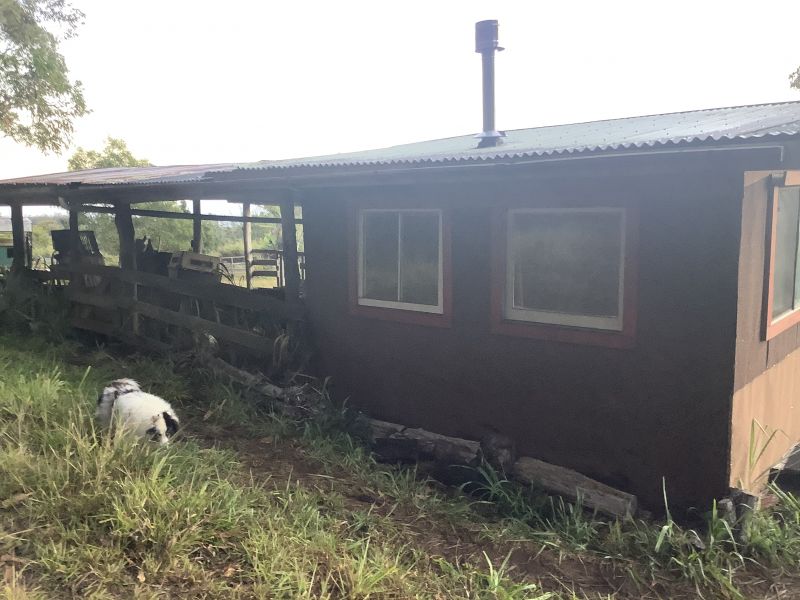

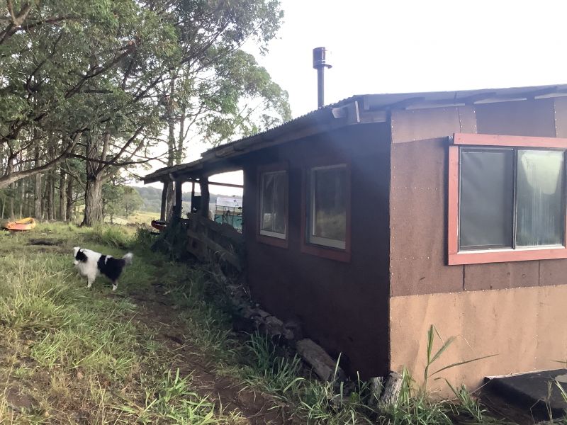

But I'm interested in the existing cabin/shed you referenced? Do you have any pictures of it?

The existing cabin is attached to our rain shed/tractor shed storage area on one side. That’s one downside - no peace and quiet here!
The “ugly” tar paper siding can be removed. It’s built primarily from Eucalyptus lumber milled on my family’s farm (we don’t have the sawmill anymore) so the wood is extremely hard.

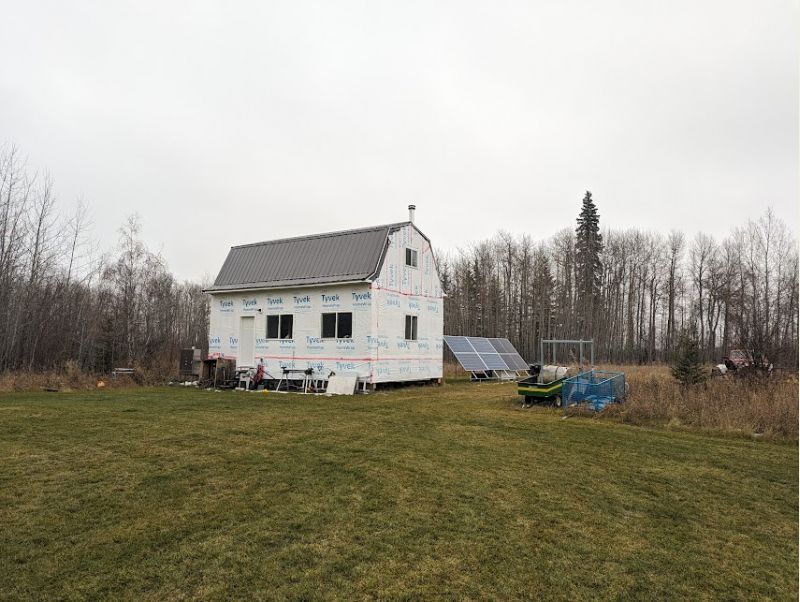

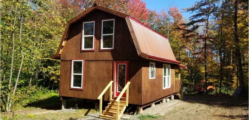

We built a 16X28 cabin with a 2/3rd loft. We built most of it at the height of COVID. Our costs for just the completed cabin were around $65K cdn. The cabin was built following all local building codes. Those costs would include EVERYTHING in the cabin(wood stove, refrigerator, mini split, building materials, insulation, ect ect). Many of the items were bought second hand or for a deep discount. This price does not include outside siding (as its not finished yet). However, I am in Canada and things cost more here. It probably would have been 40-43K in the US!
However, we really didn't skimp on much. There are areas where we could have saved a significant amount of money if we had done things different. As an example, the interior is completely finished out like a house (drywall, mud, tape, paint, plank vinyl floor, tiles, ect). We could have choose cheaper finishings and saved at least 3-5K. Another area is the Gambrel roof with full stand up loft. I estimate that drove up costs another 5K.
Here are some things that add up quickly and can really reduce costs if you get them second hand.
1. Windows (as already mentioned)
2. Exterior door (shocking what these cost)
3. Cabinets (kitchen and bathroom)
4. Shower stall ($600-1000 if bought new)
5. Insulation
6. Roofing material
I would start looking for these items ASAP. Kijiji, Craigslist, Facebook Marketplace and second hand stores are gold mines. Around here Habitat for Humanity runs second hand building stores (branded as ReStore) that are amazing. My wife was part of a bunch of "Freecycle" groups on Facebook and scored us and entire kitchen worth of cabinets in good shape. That alone saved us thousands.
Personally, I don't think you will be able to build a decent livable cabin for $15K (at least of that size). However, you can absolutely build the shell with siding and insulation for that. You could start there and then continue adding slowly over time. Buying used or discounted as you find them!
P.S. Here is a picture of our cabin (the solar system is not included in that price)

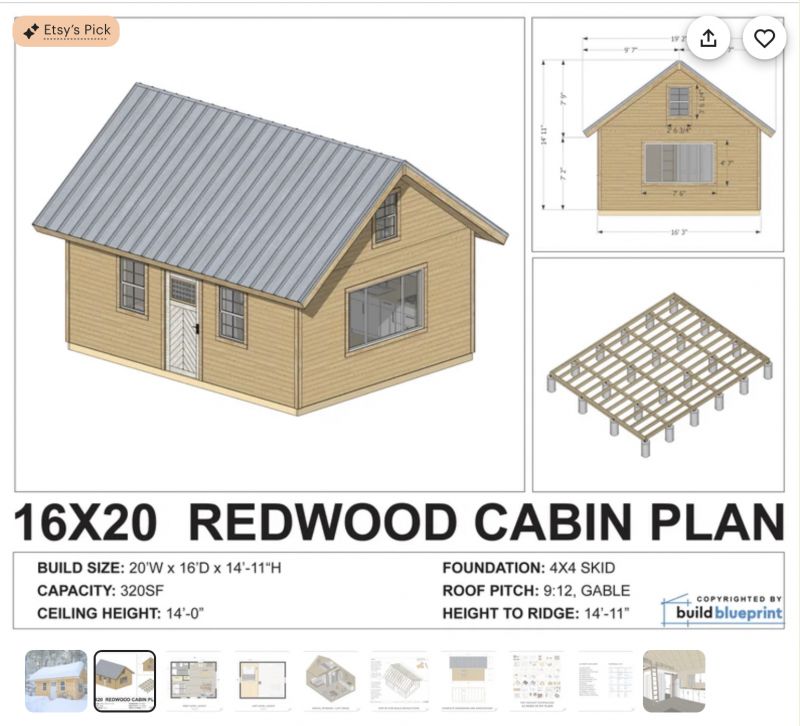

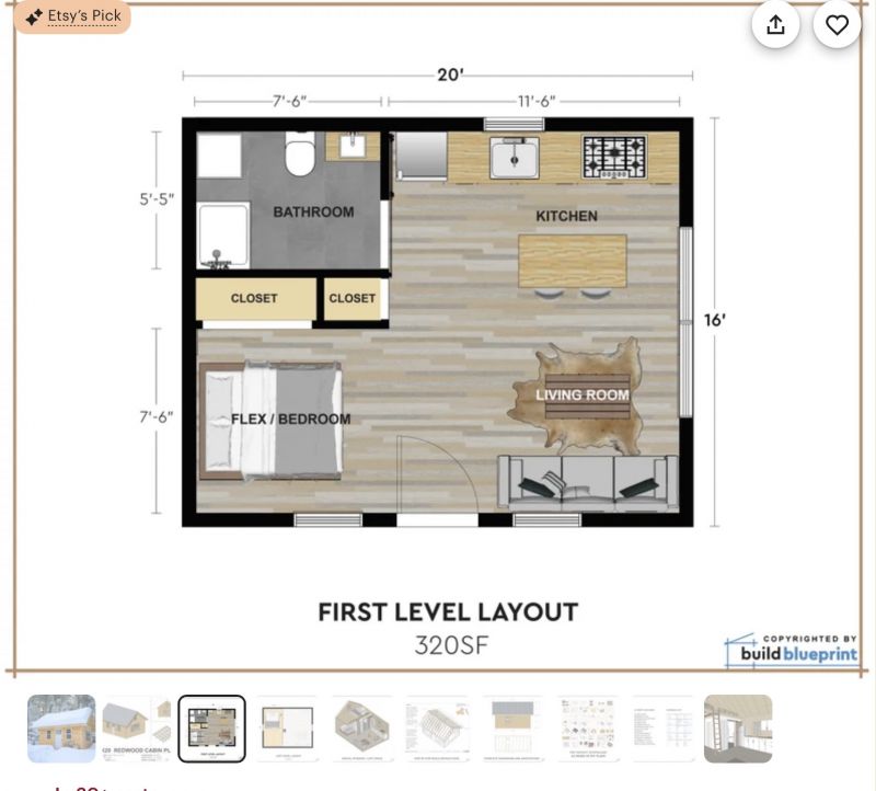

# Posted: 17 Jul 2025 05:31pm - Edited by: Emma

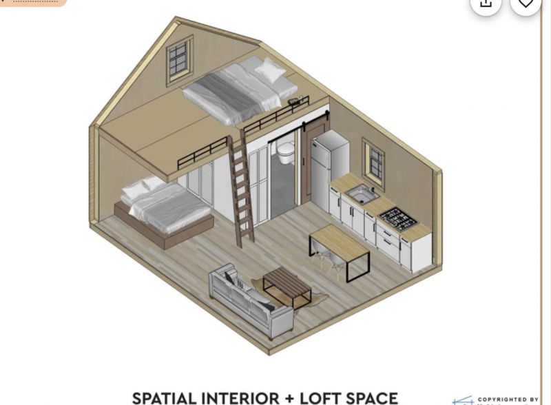

This is the house plan I was looking at on Etsy. If I don’t get this exact one, I’d probably design something like this. I really want a loft and porch
DRP
# Posted: 17 Jul 2025 07:18pm
In the 3rd pic, loft, notice the roof line beyond the pillow... there is no room for one's head on that pillow before striking the roof. That loft it just about unusable as drawn. At a 12/12 pitch I can walk upright right under the ridge on a 16' wide building. Then floor the entire upstairs and access with a pull down ladder. Explore attic trusses that spring from the overhang, that would effectively make the roof 18-20' wide potentially with more useable room upstairs.
Likewise, that foundation is insane. This was not drawn by a competent individual but it does have good points. Take the good, fix the bad.
