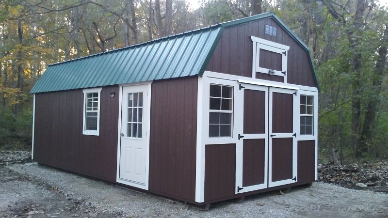

# Posted: 18 Jul 2025 02:20pm - Edited by: darz5150
I know they are probably not in your area. But check out Country Side Barns.
I designed and bought one in 2019
And am very happy with it.
They have sheds, cabins, chicken coop etc.
If you check out their website it might help you with what may be available near you.
2 lofts
2 lofts

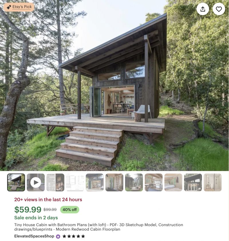

# Posted: 29 Jul 2025 05:37pm
This is another design concept I like
DRP
# Posted: 29 Jul 2025 09:12pm
A monoslope (or shed) roof. One way to look at it is, it is potentially half a house. IF you size the upper beam as if it were carrying a roof dropping from the other side... pre planning if you want .
You are in a seismic zone. that foundation, well I've read the reports from HI on its failures. Check with the county on what they require, can it be prescriptive, we can help there, or does the foundation need to be engineered. The foundation pictured is not prescriptive it is, not to "code" (prescriptively), to be prescriptive, to normal code, it would need to be better than that. You are in a seismically active area, they may require more than "normal", which is the engineer's playground. In any event, to build that in an inspected environment needs the services of an engineer. My question is whether you always need an engineer there?

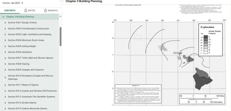

I've gone into your foundation codes breifly, prescriptive looks stock, stuff I'm used to. problem is, look at the map below, I don't know what seismic zone you are in.... In other words, let's start here, first bite, how bad are you shaking.
Yes, all plans have to get a structural engineer’s signature here. You can have someone else draft the plan and then send it to the engineer for review. I figured any of the plans I was looking at wouldn’t have suitable foundations. The only kind of foundation I have experience building is a post and pier but they changed the building code, and that isn’t allowed anymore.
Based on the map, I am in seismic zone D2.

Go here and read R301.1.3 "Engineered Design" https://codes.iccsafe.org/content/IRC2018P7/chapter-3-building-planning
Do everything possible according to what is in the following chapters to avoid further engineering costs. If you follow the methods the code prescribes, your code, the codified (written) construction law, says no engineering is required. If the plan is simple, well drawn and clearly fully prescriptive, I would submit without a seal and politely point to that section. Don't get off on the wrong foot but that is the state law. I'm also not at all opposed to an engineer checking you and that may be a local law along those lines. There is money there so worth finding out.
With the D2 seismic designation you can now go to chapter 4 and start looking for foundations that are allowed in D2. I think you will be surprised, there are several prescriptive options.
Here it is;
https://codes.iccsafe.org/content/IRC2018P7/chapter-4-foundations
Read the last line of "Applications", a wood foundation entails engineering costs... lets keep looking. Go to R403.1.2 and .3 . From here on out pay attention to anything related to your seismic designation, and double check with the building dept that D2 is what they are inspecting for. Go through all those references in the footnotes in R403.1.3 then come back, read the next section and read the references verse by verse.
The cliff notes, a slab or a full perimeter footing that is directly under the solid foundation walls, which are directly under the exterior walls above. A solid, continuous, braced load path. It does require more steel and concrete reinforcement than here, but not onerously more at all. If it gets fancier than that, engineering is probably required.
