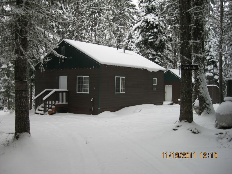

# Posted: 21 Nov 2011 09:48pm
What everyone else said! here's mine:
http://www.small-cabin.com/forum/6_645_0.html
Jared
# Posted: 22 Nov 2011 10:00pm
Thanks Borrego! Pictures are better for me sometimes and those pics are just what I needed. My wife and I are wanting the exact same roof, so it was nice to see how that would be done with a pole barn type construction. I appreciate it.

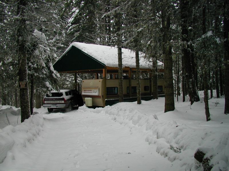

daverd4
# Posted: 5 Dec 2011 11:14am
We turned a pole barn snow roof in to a cabin it worked pretty well and was a lot cheaper. If your in snow country make sure you put a footing under the posts or they will sink from the weight
