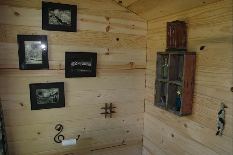

I have used 1x6x8' T&G pine in my cabins and at home. It is $0.42 per linear foot at Home Depot. It is just plain pine at that price. You will have to dig a bit to get all straight boards, and they don't stay that way. You will also want a finish nailer and a compressor for the job. Doing it by hammer and nail is simple but very time consuming.

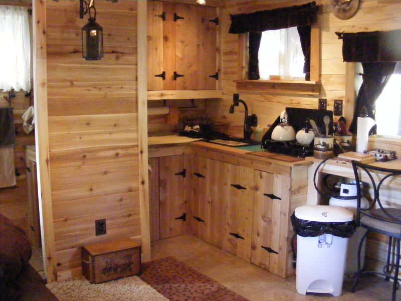

Part time,
My wife and I used cedar T&G. Found it on craigslist for a good price. It is utility grade so it has more knots in it. We both think it looks pretty good. Just a thought.

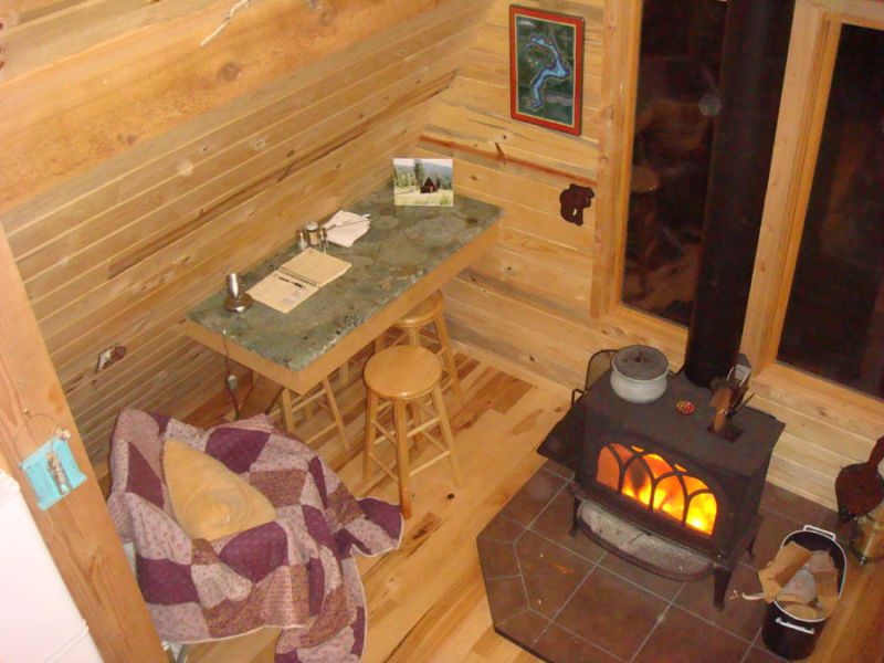

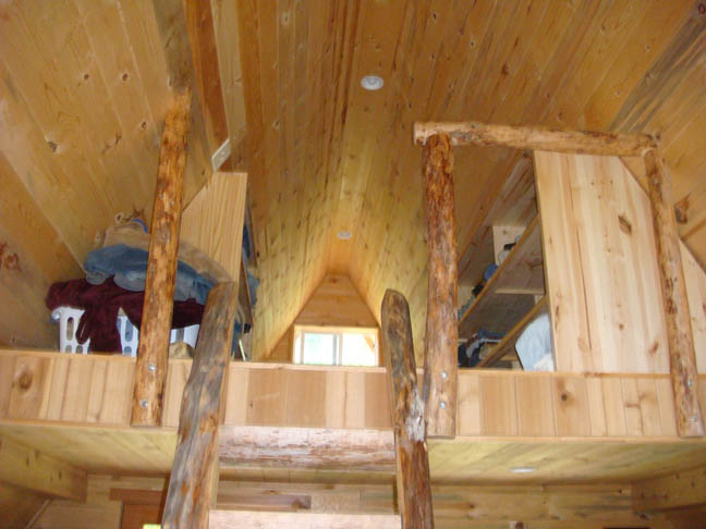

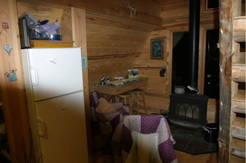

# Posted: 23 Feb 2012 04:30pm
Hick, That cedar looks great !!
Rif, and Anon,
This is a blue pine, so the stuff at HD has a bit less character. Of course, I got hammered on the price, and would have just used the less expensive wood, had I a choice at the time. We did not finish any of the walls. It is just raw wood. We had intended to clear coat it, but have not got around to it, and after 5 years, probably won't.

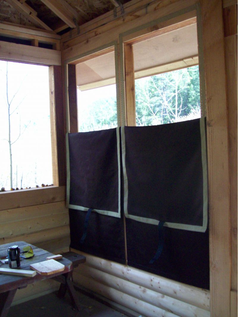

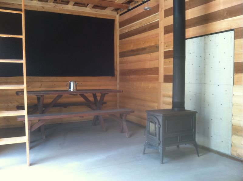

Not very fancy but I found cedar pickets for a steal -- they gave it a rustic look and sure smell great.
# Posted: 26 Feb 2012 01:37pm
brokeneck...This is very nice looking!!!! Is the black panel chalkboard?

Brokeneck, I'm looking to get a rustic look, I like the way your interior came out. I went over to Home Depot yesterday and priced out cedar fence board, it's almost the same cost as there whitewood t&g by the sq ft. I had been looking to deal direct with small sawmills but it looks like I can maybe get better pricing from lumber yards due to volume.

Quoting: trollbridge brokeneck...This is very nice looking!!!! Is the black panel chalkboard?
No the cabin is a screen house in the summer -- that's one of the heavy waxed canvas curtains a friend of mine sewed up for us. They velcro tightly down to cover the screens -- and they roll up -- or down - out of the way when not needed.

Yeah I found it on craidslist for about 1/3 what Home Depot asks....
