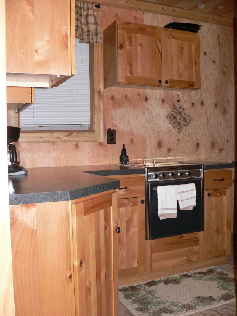

Quoting: Part time Toyota,Do you have any pics of your interior? If I put up plywood I'm thinking about putting up battens so it would look like vertical planks. Did you stain or clear coat the plywood?Thanks
Part Time, I do have pictures of the inside. I have them posted in this forum, but will post a few to this thread too. At work now. Will send when I get home.

Don, I wrapped the inside of mine with a vapor barrier and sealed it air tight. Just under my plywood wall interior. Under the exterior sheathing is also Tyvek house wrap. My son in law did the insulation, and wrapping. He does this professionally. I know depending on climate can determine where and how much vapor barrier one uses. Interior sheating in 3/8" plywood
