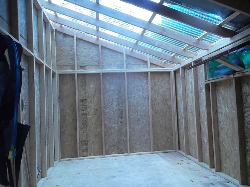

I have found a picture of the Suntuff installed. It is a shed, so there are walls, unlike what you are doing.
The install is super easy, but you do need those fancy screws plus other things for proper install.
Whatever you do, good luck!
