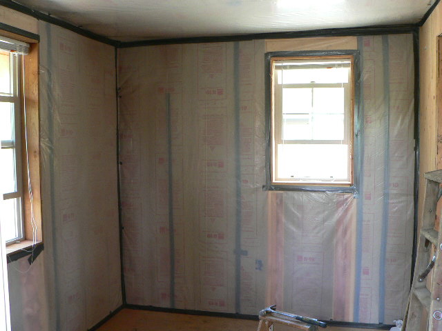

# Posted: 2 May 2010 08:39pm
I just got back from insulating mine. I used R19 and already had a vapor barrier under the siding, I also added another vapor barrier, sealed the interior one air tight. I can heat it with a match now. If you dont use it in the winter, still insulate, keep it cool in the summer.
R19 on 2X6 exterior walls
Plastic wrapped and air tight.
