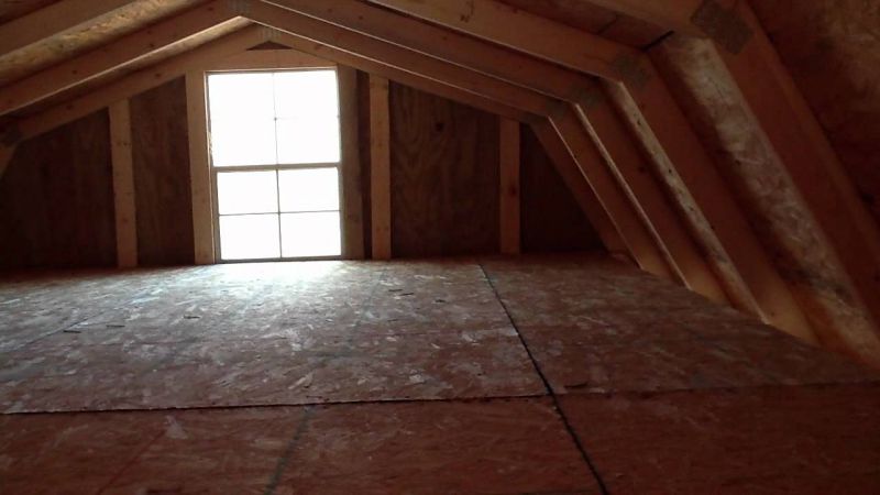

 Quoting: karlscabin  I plan to paint the interior walls and ceiling with Kilz primer, PRIOR to adding insulation.   Can i ask how the Kilz helps? I am struggling to find consistent info on how to insulate the roof area since it will be open and there will be a loft on one end. We live in Oklahoma and it gets really windy and cold and very hot in the summer . I have shade trees where i will be placing it but the back of the house will be facing North but not windows so i just wanted it to be as comfortable as possible. Any suggestions would be great.  loft_area.jpg

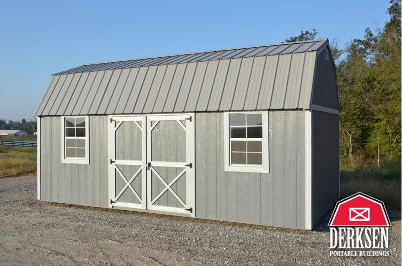

  I have the same shed pictured above (side lofted barn), I have run power through the whole thing and put in can lights under the lofts. My question is this, there is no ridge vent and any insulation I put in the ceiling would not vent. There is no tyvec/wrap on the exterior frame and I want to assure I don't have moisture/rot issues in the future. I will only be using the shed as a mancave/shop and will only be heating it for 2-3 hours at a time. I have been looking to determine what insulation I should use and how to do it to avoid any issues in the future. One contractor suggested I don’t insulate it and buy a bigger heater; his point is it is a shed and was not built to have proper ventilation for use with insulation. I live in Seattle where January/February are the coldest times a year and most of the time 40’s is as cold as it gets. The walls are 2 x 4, what insulation should I use? Would it be fine to not use insulation and just put up a vapor barrier on the inside?   Ideas/Suggestions?
