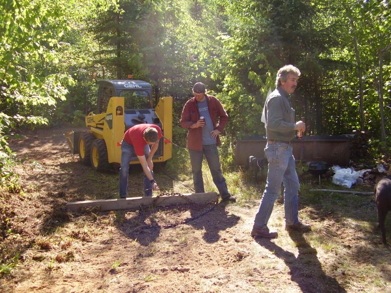

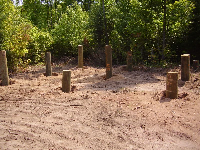

The soil at my cabin is very very hard/rocky. It's clay and sandstone. I tried to dig by hand and then with a power auger, but neither worked. i rented a skid steer with an 18" auger. That worked. The whole shooting match was $310 for the weekend. Friday afternoon thru monday morning was one day rental rate. That included the 6400 pound tractor, bucket, drill attachment, chains/binders and diesel. BYO trailer.
A camp down the road from me is built on railroad ties as a foundation. They are just laid on grade. Been there for 25 years.
