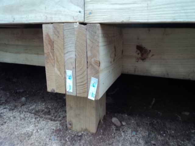

# Posted: 15 Dec 2013 09:42pm
  I'm trying to understand what you mean by treated skids. The only skid I've ever known is a shipping palate. Is this just two laminated beams held together with a couple 2x8s?
# Posted: 16 Dec 2013 09:09pm
  Yes, that's about it.  skids on posts
  |   skids or beams same thing
Sambo

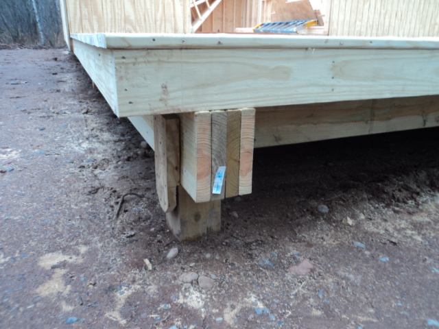

# Posted: 17 Dec 2013 03:53pm
  In the second picture, what's the purpose of that piece of lumber that lips over the post from the beam?
# Posted: 19 Dec 2013 06:18pm
  Just to tie the posts to the beams.
