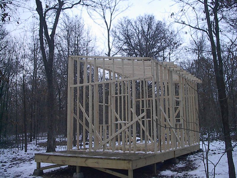

I'm building a small cabin and need advice on the window installation. I have finished framing the walls and now want to install a product called smartside panels. With the smartside panels you are not required to have a sheathing material installed prior to installation. I will be using the smartside as the sheathing material. The question is, Do I install the siding then cut out the window holes then install the windows over the siding then trim it out or windows first then siding?

I'm really interested in shed roof cabins. Would you please tell us more about yours? Is it 12'x20' ? Any more pictures? Thanks
JRanch
# Posted: 20 Feb 2010 05:25pm
That looks to be 12x16, are you going to do a loft and if so, how big will it be and which way will you position it?
