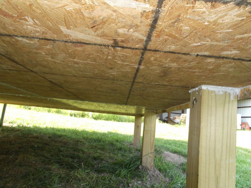

I used R-19 installed between the joists and then added 1/2 plywood and caulked all the edges to keep the critters out. It is about 18" from the ground at the lowest part and 3 1/2 ft. at the highest. I did add roofing felt under my tongue and groove floor that I applied on the inside. We'll see how easy it is to heat this winter.

Quoting: missouriboy used R-19 installed between the joists and then added 1/2 plywood and caulked all the edges to keep the critters out. It is about 18" from the ground at the lowest part and 3 1/2 ft. at the highest. I did add roofing felt under my tongue and groove floor that I applied on the inside. We'll see how easy it is to heat this winter.
Missouriboy, wrap your pier post with metal flashing. This will make it impossible for the critters to climb up to gnaw a hole into your wood.

basrijin, I used R19 (6 1/2") insulation. That is more than the typical wall which is R13 (3 1/2") plus heat rises so I figured it would be good enough for the floor. Had no trouble heating my 12 x 24 cabin with a 1500 watt electric heater this past weekend. Kept it 70 degrees inside with no problems.
