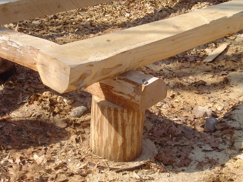

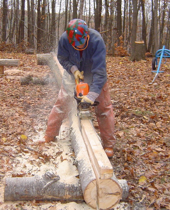

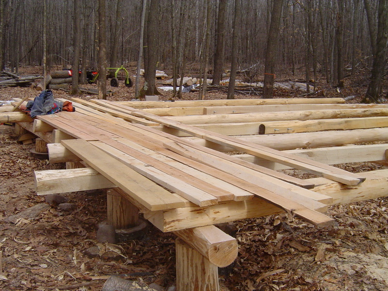

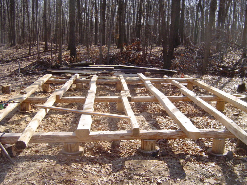

fpw
# Posted: 1 Dec 2013 13:20
Here are some floor photos
