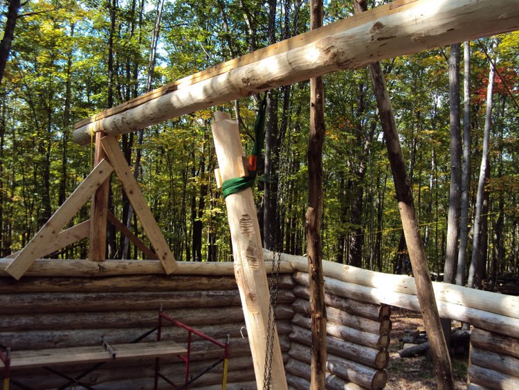

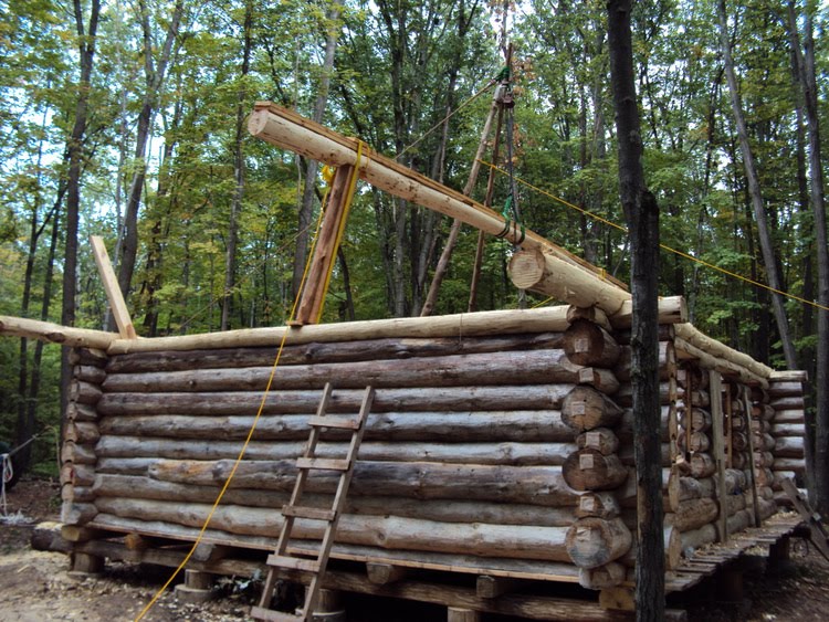

# Posted: 3 Dec 2013 11:56am
Simple post and beam ridge. One post on each gable and a center post installed. This cabin is 20' x 22' (inside dimensions).
Building a gable support as indicated above is pretty straight forward. DSC00365.JPG

Malamute
# Posted: 3 Dec 2013 12:46pm
It depends on how dry your logs are, and you can compensate for settling. That should be done with any logs, unless its a very small cabin and the logs are very dry already. Doors and windows should be framed so that the logs can settle around them. It isn't as hard as many think at first.
It looks to me like raising a post and the ridge is more complicated than building simple log gable walls. Logs can be simply ramped up with poles laid against the walls and a hand winch or block and tackle without a gin pole as shown in the above pictures. I built a simple movable winch platform to move logs, I was able to move all my logs (once on site) by myself. I could have also just used poles or boards as ramps. The rope come-a-long winches are simple to use and entirely up to the job of moving or lifting logs.
