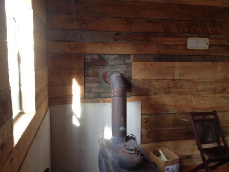

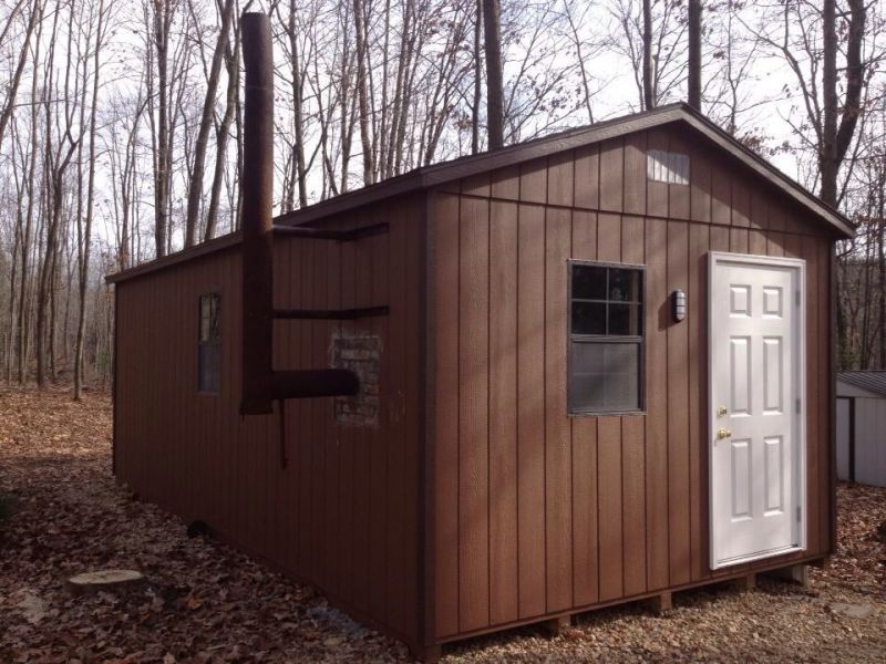

 I like it!  When you went through the wall what did you use?  It looks like you may have cut out the siding and from there I can't tell.  I got a stove now and want to install it but really having a hard time to decide through the roof or not.  I have plywood and tin only on roof and side walls.
 Tell me what I need to do?  LOL  I have been around stoves most of my life but have never installed one.  I want to do it right don't want to burn the shack down.  LOL
| foxdud Member
 | # Posted: 11 Dec 2013 12:43pm Reply
 I just went between the studs cut the hole and used 2 2x4"s nailed together and started laying brick around the stove pipe. no problem at all.
| foxdud Member
 | # Posted: 11 Dec 2013 12:54pm Reply
 use 2 0r 3 pieces of 2x4 nailed together for your shelf to lay the brick on to support the weight of the brick. then on the outside I drilled 2 holes in each metal supports you see and lag bolted it into the studs. so 4 big lag bolts on the outside to hold the chimney in place along with laying the brick around the stove pipe going through the wall will support everything. the only thing I would suggest you do different is use fire brick instead of the regular old red brick I used... Also I used cement board on my floor and wall behind the stove to prevent the wall from over heating. I also plan on stoning over the cement board. you would be surprised how much heat the stones will hold after the fire is out. my stove will run you out of our cabin, It gets so hot in there we almost always have to open the windows and doors. I was just up there last week as it is deer season here and I was sitting in the cabin with shorts on and drinking a cold beer while it was 21 degrees outside and had the front and back doors both open along with all 3 windows.
| neb Member
 | # Posted: 11 Dec 2013 07:14pm Reply
 HA ha ha did your beer get warm?  I have been around stoves for many years but never had to install one so this is new for me.  Looks good and great idea.  Thanks

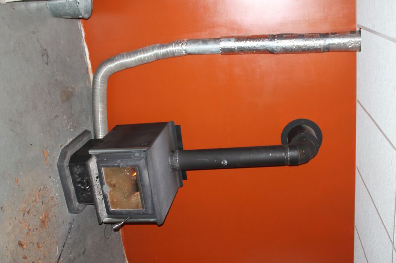

| SubArcticGuy Member
 | # Posted: 15 Dec 2013 02:28am - Edited by: SubArcticGuy Reply
 Hey Neb,   Here is a couple of pictures of the interior...The outside is pretty self explanatory (and it is 12:20am and it is snowing and blowing outside so I am not getting a photo)
 I put some foil bubble wrap on the first section of pipe because I Would get some condensation on it otherwise.   The stove has an adapter that goes right onto the back of the stove so I don't get strong downdrafts filling the room.
 I would love to find a way to hide that pipe in the wall but I haven't gotten to it yet.   I don't want to loose that much insulation out of the wall but I have thought about doing a built out mantel/stonework or tile of some kind to but some boxed tin ducting back there.

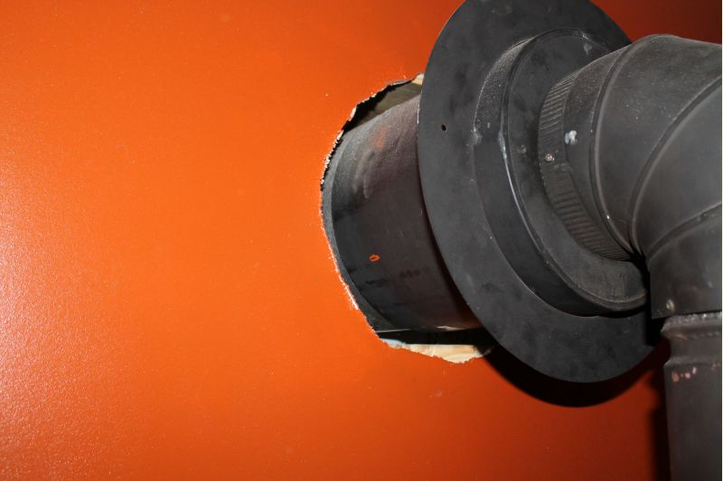

 The second photo is just of the trim plate removed from the wall.  The thimble is cold to the touch on the bottom and slightly cooler than room temperature on the top right now.
 The chimney outside just has a 90° with a cleanout and goes up well past the roofline.  I only have 10" eaves (plus a gutter) so I put it out past that.     The cleanout is maybe 18" off the ground but I can get a fibreglass rod cleaning brush up there quite easily.   Once a year I will also use a screwdriver or something to clear the crud around the chimney cap as well (in the snow free season).
 I have to rebuild the roof this year so I was thinking about extending the eves...if I do I will just trim around the chimney and keep the 10" eave there to avoid having to mess around with a through the roof system.   I am thinking tin for the roof so I will want to put up a snow deflector though to keep sliding snow from taking out the chimney   (saw that happen down the road last spring).
