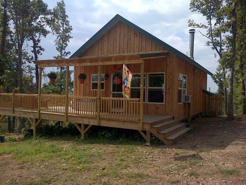

on my southern camp ( 20' x 30' ) ...I used board and batten HEMLOCK...is was cut in North Carolina....
on my Northern hunting camp in Maine...I used Hemlock as well...reasonable priced and looks great!!!

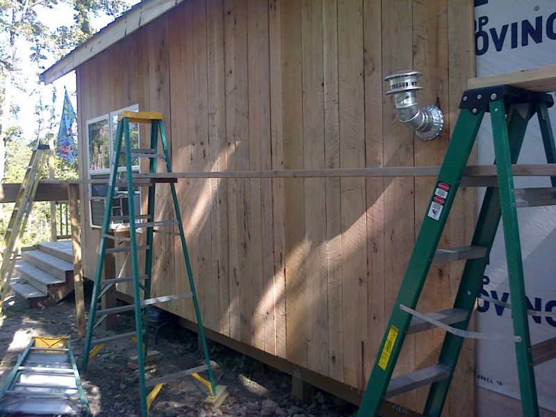

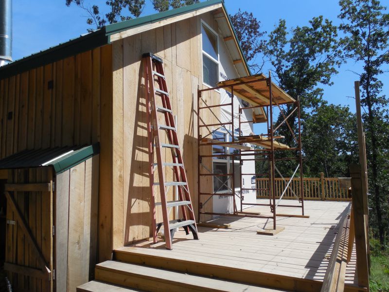

# Posted: 29 Apr 2014 20:37
Rough cut oak board and batten. let it dry for a couple of weeks and applied Thompson's.
I like the look and it will last for a LONG time. Pretty cheap, too.
Heavy.....very heavy. Putting it up aged me 20 years.

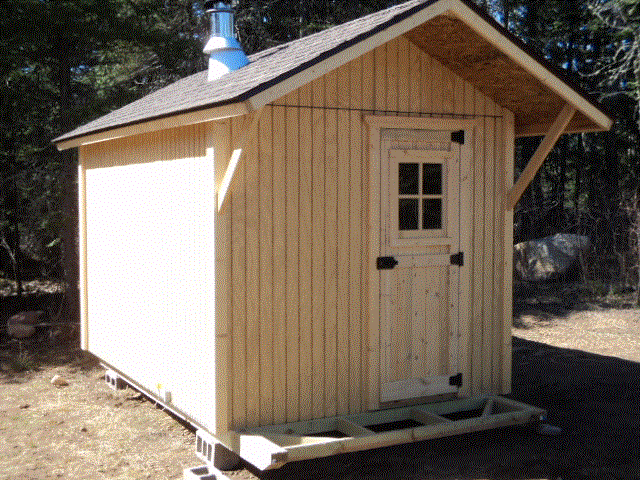

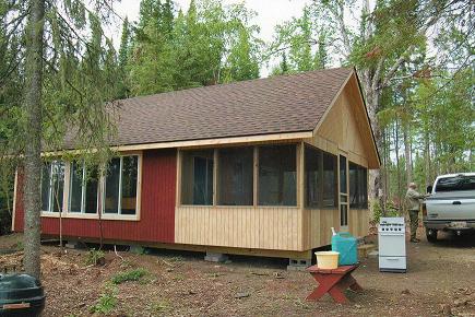

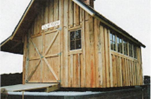

# Posted: 29 Apr 2014 21:23 - Edited by: OwenChristensen
I use a lot of Southern Yellow pine T1-11. It last a long time and adds a lot of strength to your walls. If I use any lap type siding , I use OSB under it to make back the strength lost with lap siding.

Shadyacres
# Posted: 29 Apr 2014 21:37
Very nice OwenChristensen .

# Posted: 29 Apr 2014 22:01
Here you go...

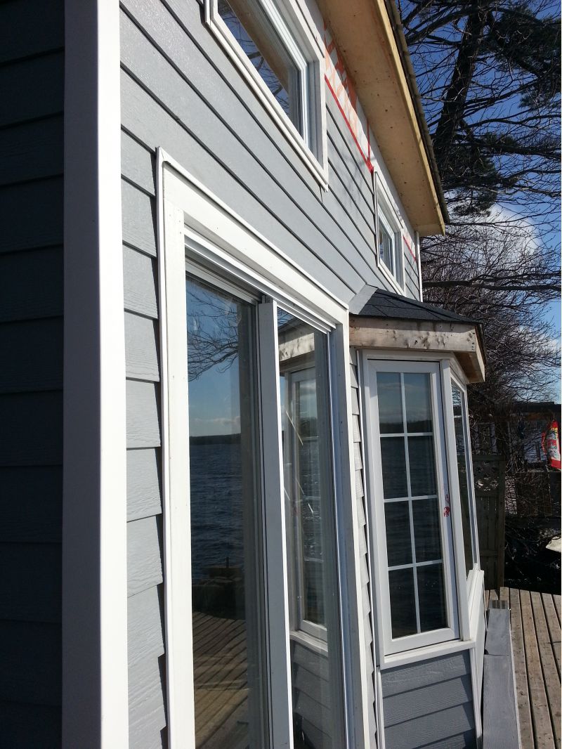

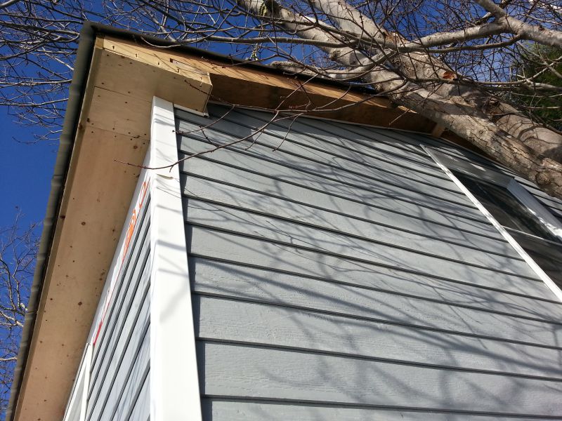

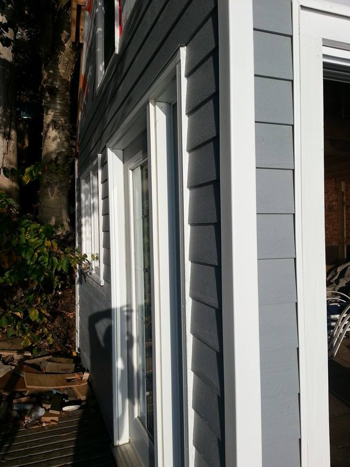

# Posted: 29 Apr 2014 22:13 - Edited by: MtnDon
Cement fiber (Hardi) lap siding over #15 building felt, over OSB sheathing nailed to the studs.
Because it is fire rated.
Because it is insect resistant.
Because it is not going to rot.
Because it holds paint well; better than many wood siding materials. Good paint will last decades. Clear finishes and semi transparent stains do not last nearly as long, so we wanted paint for lower maintenance.
It comes in widths from 5 1/4 to 12 inches so you can pick your look.
We used the Hardi perforated/ventilated soffit material and fascia as well as window, door and corner trim.

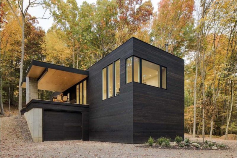

Even though the original post was from 2014 and the siding has long been attached, I went with burnt cedar rabbited siding for the lower half and cement panels for the upper section, under eaves and the fascia.
With all the wildfires happening each year there's no better choice than to use a fire proof product. Since the cedar siding has already been burnt with a torch it doesn't ignite again. Cement board (like Hardie panels) should be used under all overhangs since a fire can race up the wall and become trapped under the eave causing a roof fire.
And forget cedar shake roofs. Go with standing seam metal with a fire proof membrane underneath so the roof deck doesn't ignite.

not my cabin
