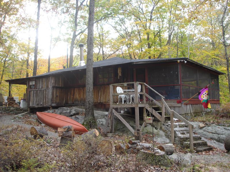

I know it's not an option any more, but our cabin is sided with vertical chestnut log slabs from all the trees that were cut down as "salvage logging" during the chestnut blight 80 years ago. Some people in the area have rebuilt using modern curved "log" siding in the same arrangement, though of course it's not as pleasing as the old rough cut logs.

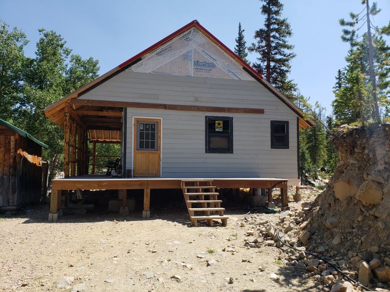

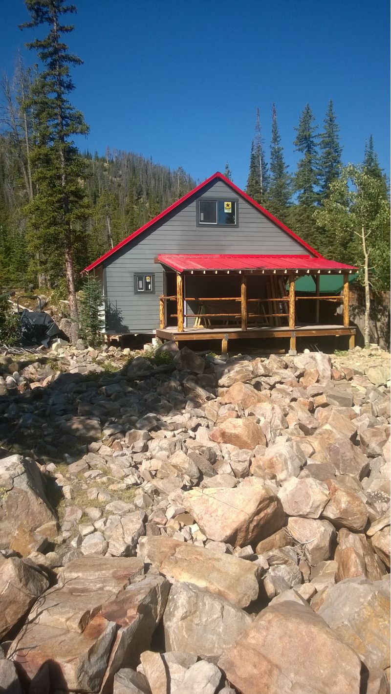

Hardi panels, the 4 x 8' sheets. Our cabin is in the desert and I needed the most durable product, period. No battens as I don't like the look...
# Posted: 16 Aug 2018 14:37
Hardi cement fiber lap siding. Because it is fire resistant and holds paint very well. No blistering or flaking like can happen with wood. I also used their cement fiberboard trim, soffit and fascia material.

I use hardie board plank siding. It's the most durable and trouble free option. The completed side we did last year, currently working on the front.
# Posted: 16 Aug 2018 17:45
Yeah, Hardi holds paint like crazy.....5 years of desert sun and it still looks like new. I even ripped some of the panels and made 'covers' for the fascia. Only way to go......
