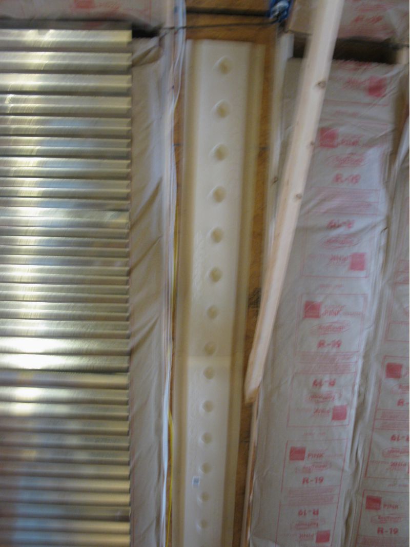

# Posted: 22 Apr 2013 05:37pm - Edited by: Purplerules
Reply Quote
Here is a pic of what we we finally did to vent roof. Since we are only dealing with heat mostly and not snow. We used the foam vent slots and the insulation still fit nicely between the rafters.
Malamute
# Posted: 22 Apr 2013 10:29pm - Edited by: Malamute
Reply Quote
There is also "C" (for cathedral I believe) type batts, its rated the same R factor as standard batts, but is slightly compressed to give about 3/4"-1" of air space to vent. I've used them on cathedral ceilings, they seem to work fine.
After having dealt with a number of houses that leaked air into the living space when it's windy, I've quit using faced insulation. Its nearly impossible to keep the paper totally intact and keep from leaking air. I use unfaced, and cover with heavy mil plastic, taping the edges, and making any cuts tight to the electric boxes, windows etc. Insulators have told me they do the same thing, have mostly stopped using faced batts. I also am careful to get the walls sealed well, and edges taped to the ceiling and any penetrations. a realotr that has sold a couple of my hosues told me they were tighter than most other houses she'd sold, she said she can generally tell when she walks in them if they're tight.
Using plastic over faced batts can trap moisture, and is to be avoided from what I've been told by insulators. One can pull the paper off and plastic over it though. any stapler holes need to be taped, and edges/seams taped. Same for tyvek, tape all holes, edges etc.
One other difference between walls and roofs, walls breathe some, roofs dont. Tyvek allows minute amounts of moisture out, roofing doesn't.
