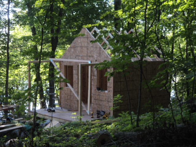

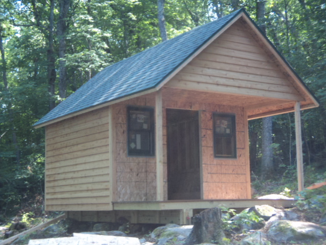

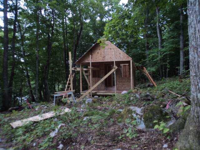

I've done a few. I think it a good idea, as long as it can't freeze in cold weather. Here's a 12 x 12 with an additional 6' covered porch, I'm building now. It will have a large lake water tank in the attic, but no toilet.
Owen

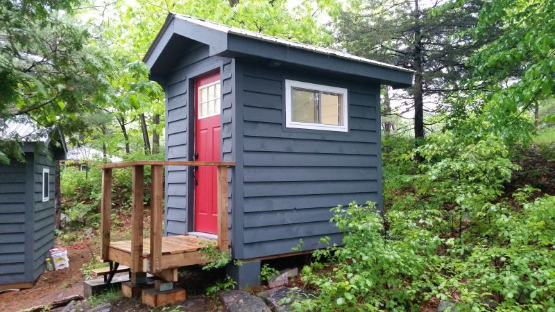

I did a small separate bathroom. It's about 6' x 6' and has a shower, composting toilet and sink. you can see it on my thread here.. It's been great as the boys using the bunkie down the trail can use it without tying up the bathroom in the main cottage.
mj1angier

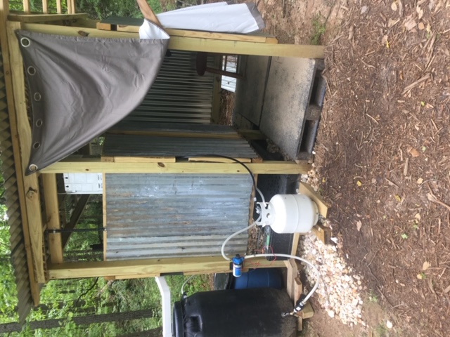

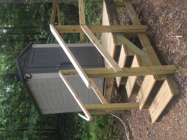

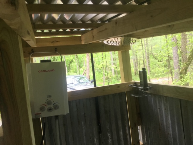

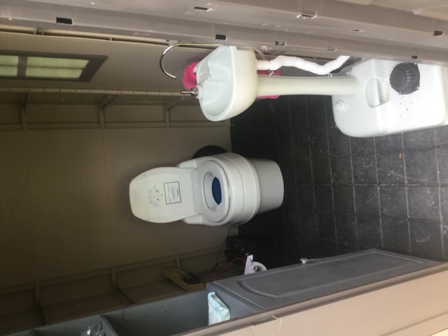

Here are our outhouse and shower at our place in NC foothills.
The toilet is a 4x6 plastic shed that one of us had. It works good for our composting toilet other than it needs working windows- get hot in summer, lol
The shower stall is U shaped to have a dry area. It's fed from the rain gutters but we also have a creek 50 ft away we can pump from. The floor is plastic pallets like breweries use to stack kegs. I have enclosed the pumps and batteries scene these photos.
Edit: dang photos are sideways and I can see how to change them IMG_0245.JPG
