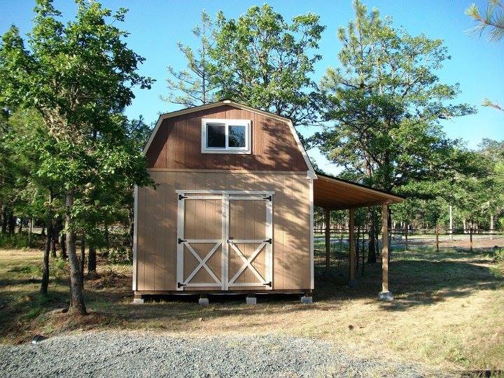

  So the builders do a variety of attached shelters to their barns, sheds, small homes/cabins. I do want a carport.
  On one hand, it would be neat to have a carport attached to the back of the gambrel cabin so I could drive in and have a back door by which to enter the cabin. It would also remove the necessity of a "mud room."
  On the other hand, I wonder what a carport on the back would do to the load balance of the structure? Would it put a strain on any part of the structure of the cabin? I wouldn't want that.
  Here is a picture of a lightweight shelter attached to a shed barn that the guys have done. They've also done much more substantial attached shelters. OR I could ask them to build a separate carport.
  I haven't addressed the carport issue with them yet. But I need to do that because we're going to be drawing up the plans soon. So, which way do you guys think I should go with this? From my standpoint, as long as I have a carport, I'll be happy. I want what's structurally best for the cabin and I can adjust anything else accordingly.
Don_P
# Posted: 21 Feb 2016 09:41pm - Edited by: Don_P
  Attached it protects the building by moving the water away. Snow piles up on the shed roof transition, detail well and check potential loads. The roof carrying beam on the outside of the shed between joists looks inadequate, engineer all of this. While doing so have it built to take a floor load and walls... easy expansion room, I'd do it on both sides and make one a porch. I did one side and then hipped around and across the end of the barn.

  There is no issue with the carport upsetting the structural balance, if I understand your question. It will be designed to support itself.

# Posted: 22 Feb 2016 06:21pm
 Quoting: Julie2Oregon The reason I was wondering is that my neighbor's wide porch got "uprooted," picked up, and basically folded over her house in a windstorm we had here. The wind wasn't even near tornadic. The porch was part of the structure and at the same height/level as the rest of the house and that's why I wondered if there was some sort of imbalance at play when you attach a large, open structure to a house.
  The main "imbalance"there was the very weak or probably non existent tie down.  Yours might have been better built. Or, winds are fickle and you were more lucky.
# Posted: 22 Feb 2016 08:02pm
  One thing about carport or porch roofs is that they are like a sail that can get lifted if not firmly held down.

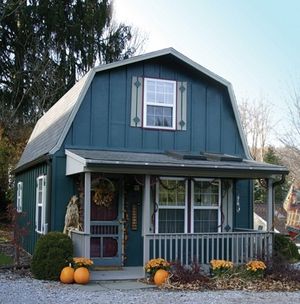

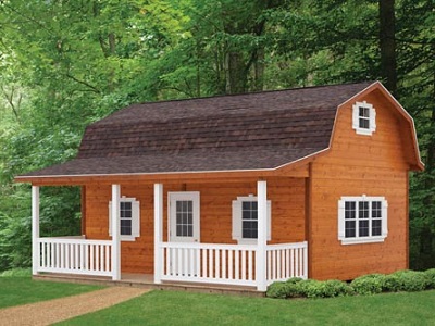

  Um......I dislike Gambrel roofs. Which, I know, has no affect on anyone else's choice or preference for them. I just find it extremely difficult to get the proportions right in designing the upper roof, lower roof and the wall widths and heights. Then there's what to do with the end walls and gables, and if a porch should be attached (end or side?). Lots and lots of variables.
  After spending 20 minutes looking at Gambrel roofed cabins on "Google Images" I found some samples. The first two pictures show really bad design (In my opinion). I would feel depressed coming over the top of the hill and seeing either one of these waiting for me at the end of a day. How basic and boring and ugly.
  The third picture is just about the only Gambrel design I could find that I liked. I realize everyone's taste is different, but as you're scanning across 100's of pics of cabins in the "Image" section of Google you can't help but have an instant reaction to each picture. Nope, nope, too narrow, too wide, roof is wrong, looks dumpy, looks cheap, etc.
  The third pic actually looks like a welcoming home rather than a converted shack or shed. While an attached carport may be nice I think you'll get far more enjoyment and use from a porch (which could still be used as an exterior mudroom).
  If your builder can even get "close" to the proportions of this cabin you'll have a beautiful home in my opinion.  Bad Gambrel 1

 Quoting: bldginsp One thing about carport or porch roofs is that they are like a sail that can get lifted if not firmly held down.
  Yes, exactly, and it's that sort of stressor that I want to make sure isn't put on the cabin. So, will giving it having weight (because it will have proper roof joists), sturdy beams, and supports cemented into the ground be sufficient?

  It's not its weight that matters, it's tying it down. In the concrete footings you have post bases set in the concrete that are bolted to the posts. Then at the top of the posts metal straps tie the roof beams to the posts. Finally hurricane clips tie the rafters to the beams. For it to be lifted up it has to take the concrete with it, which it won't. If it isn't tied this way, the joints break and the roof takes off like a hang glider- hopefully without Julie hanging on.

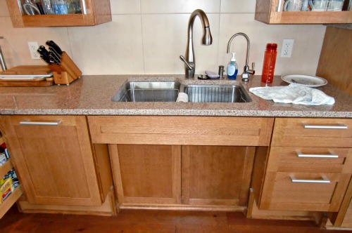

  You might also consider having no cabinet (or a recessed one)under the sink and stovetop so that you can get closer to the counter when cooking and doing dishes.

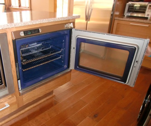

  A major concern (if you do separate the stovetop from the oven) is accessing the oven when the door is open. This is very difficult to do in a seated position so you might consider a sideways opening oven door. If you are seated and don't want to reach across a hot burner while using the stovetop you might consider an "induction" stovetop or burner instead (which doesn't get hot, just the pan or pot does).
