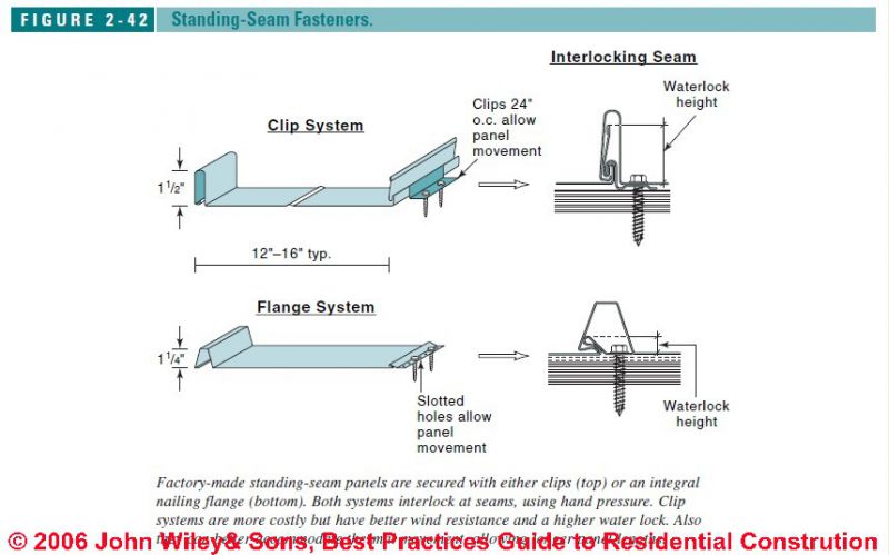

# Posted: 11 May 2016 08:53pm
Since you are doing a very simple shed roof with a low slope and you are in a rainy area I would recommend using a metal standing seam roof. If you order the sheets for the width of the roof you will be able to run one sheet right across the entire roof.
Hidden fasteners are available so that when the next panel is locked in place it cover up the fasteners. You won't have to drill hundreds of holes like you would for the corrugated metal panels and you could order all the edge flashing and insect stops from the same manufacturer.
Sample Standing Seam Metal Roof
