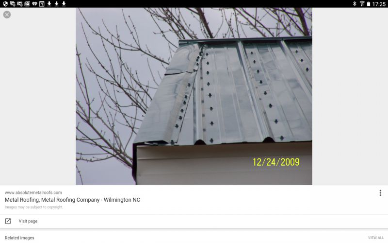

Quoting: AK Seabee
I place the structural screws directly adjacent to the rib
I wonder if you could provide more detail on what you mean by this? Do the screws go in at an angle, low on the rib?

Not my roof but the screenshot shows the screws adjacent to the rib

wow, I hope not yours. That is missing some of the bottom screws. Find the manufacturers install directions, print them and have them on the jobsite. There is usually a page showing screw locations.

Don, there is alot wrong with the photo I did a screenshot of the first online photo showing the screws adjacent to the rib as that was the question asked. I probably should have looked a little longer to find a photo with the roof done correctly.
My cabin is 160 miles away so taking a photo of my roof is out of the question.
I agree with your statement. The folks selling the tin will provide installation instructions. If you dont follow the instructions they will more than likely void the warranty.
