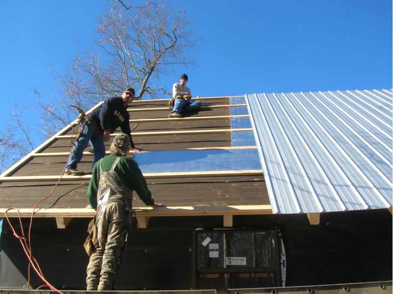

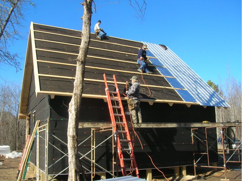

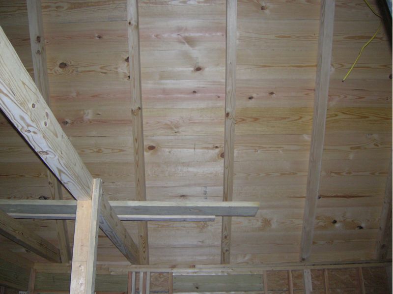

The earlier thread concerning metal roofing and condensation made me wonder about our own roof. Heres the setup: exposed rafters (i guess you would call that a cathedral ceiling), exposed 1X12 pine decking, 30lb roofing felt, 1" polyiso foam board with foil on both sides between 2x4 lathing, 26ga galvalume panels. Due to the roof/celing construction there is no ventilation like soffits or ridge vents. The exterior walls of the cabin are wrapped with tyvek and then i went over that with 15lb felt. I intend to insulate the floor and walls with R-13 roll insulation. It shouldn't be drafty but that might be a negative in this situation. I know there will be condensation on the underside of the metal but it should contact the foil and then either migrate out through the 1/2" airspace or find its way down to the felt. Am I overthinking this or will it be a problem?

Don, thanks for your input. I've read several of your posts and was hoping you would reply. We are in Mississippi and this cabin will be for part time use. It will probably see more usage in the winter and spring during the hunting seasons. Our summers are blazing hot with high humidity and our winter temps usually range from the 20s-50s. I knew the felt over the wrap was somewhat redundant but I had extra and wanted to use it somewhere (I love that black paper!). The 1" polyiso foam has an R value of 6.5 without an airspace but I wanted to leave the 1/2" space to try and address the moisture issue. Also, I haven't decided on what form of heating to install. I would like to use wood but LP gas is also an option but again I worry about the moisture. Maybe a vented LP heater? What do you think about the condensation on this roofing scenario?

# Posted: 2 Jan 2011 17:27
Outside: Moisture will likely condense in that 1/2" air space on the underside of the metal roofing. If there's a lot it may puddle along the horizontal 2x4's? Where is it going to go then? My concern is that it might seep down the joint where the foam meets the 2x4. If the sun is warm enough any water there may evaporate and vent to the outside.
Sideways air venting is not as effective as vertical venting though.
I'm with Mt Don. The set up you have now, you should remove the metal roof and add a layer of 15# felt over the top of the foam and horizontal 2X4's, layer the felt to shed water downhill. I have an enclosed metal cargo trailer (7X16) trailer it has a heater inside of it. When its heated inside and cool outside, I get big beads of sweat build up on the metal screw heads going into the metal studs. I know the metal skin on the inside of the wall is full of condensation, but its designed to roll off and own and drain out the bottom of the wall. In your case, it will sweat bad, but looks like it will have no place to go. .
