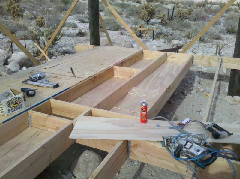

I covered the bottom of my desert cabin floor with 1/4" luan. It has 2x10 joists at 24" OC. I attached them with 8d's and sealed all gaps with either silicone or foam......
I was able to do some of mine from beneath as it is quicker, but where I couldn't get under neath i did it from above.

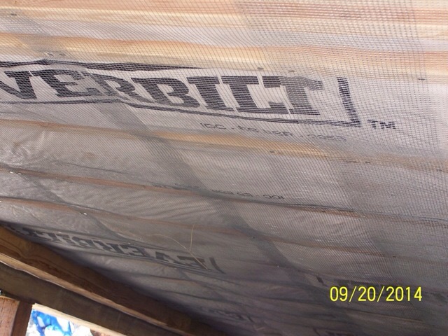

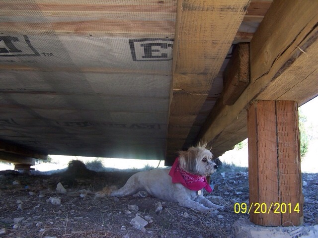

The wire mesh has worked for me in MT. Going on two years. My neighbors put it in for me. Top notch friends. I owe them lots of beer for a while.
So far it's kept out all the critters. But we also don't have armadillos...LOL!
# Posted: 22 Aug 2016 10:37am
Use what DDR has, looks like the 1/4" galvie mesh, no varmints getting through this.

DRR
# Posted: 23 Aug 2016 12:45am
Yes Sir Toyota. Some good stuff. The pics are before it was completely covered. Gotta make sure to cover every nook and cranny. So far, so good...knock on wood.
