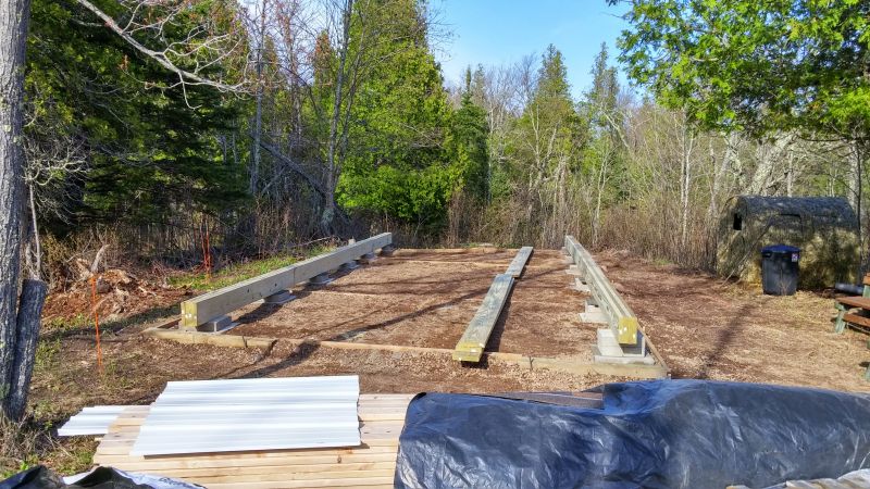

fiftyfifty
# Posted: 22 Jan 2019 06:33pm
During progress of the 16x30.

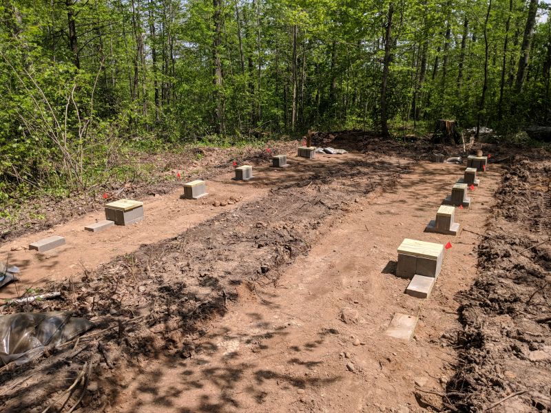

cjm
# Posted: 11 Jun 2019 10:40am - Edited by: cjm
My thought is that having it raised off the ground should mitigate the risk of rot/moisture issues. I don't think that individual piers (e.g., sono tubes) have enough benefits to be worth the cost for a small cabin. I think that piers on a full-perimeter footing would be ideal, but I don't want to spend that much.
So, I'm tentatively moving forward but we reduced the size to 16x24. We brought a skidsteer up there for a day and got a driveway roughed in (900ft long).
Then, for the cabin, we scrapped away the top soil, filled the trenches with gravel, and tamped it. I set 5 blocks on each side for the girders to sit on. I used two 4" thick solid concrete blocks to make a 16x16 base, then set cinder blocks on top. I think I might stack one more cinder block though, so it is a little higher off the ground. I still have a little grading to do next time we can get the skidsteer up there to make sure that the land on the right side of the picture slopes away.
I'm still open to any suggestions or observations. I keep debating if I should pay for some other foundation... but then I'm sure my wife will say "well then let's make it bigger" and it will balloon into something else. Right now, I can handle everything myself. It won't have running water. There are no building permits required (just a site permit). So... onward for now.
# Posted: 11 Jun 2019 07:25pm
Not sure if cinder blocks are the best option but most are good for 50+ years. We have a couple buildings sitting in them. A few have cracked. Also some were laid wrong with the holes horizontal and not vertical. I plan to someday replace a few with something better.
cjm
# Posted: 11 Jun 2019 08:28pm
What would you use instead?
# Posted: 12 Jun 2019 07:45am
By the looks your building a skid foundation but on blocks. If you get freeze thaw you will have to level it every year i hear. Not so with tubes to below frost line.

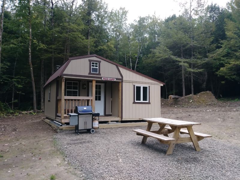

i sell cabins up to 14x40 one piece and 28x40 two piece, they are built on 4-4x6 notched skids and i usually recommend 2x6 floor joists, for foundations I scrape off the topsoil and lay at least 6" of crusher run (aka runacrush) limestone, which is laser levelled and tamped with a plate compactor, there is no reason these buildings wont last for decades
