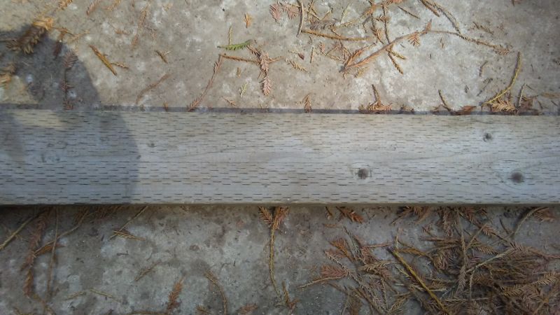

ICC, here's a pic, a faded light green, was a fence.
And a back story: A friend in the area thought his property extended past the fence line, so he had a surveyor come out. Low and behold, turned out the fence was on the neighbor's property, like ten feet! And those surveys get filed in the public records. Not only did he have to tear down the fence, he had a stone stairway next to it leading to his house he had to demolish. Shoulda let sleepng dogs lie..
Anyway, I hauled off about two dozen of these 2x6s about 14' long after cutting at the posts. No idea age of the fence, my guess is the old pt.

paulz, that does appear to be old CCA PT. I haven't seen very many 2x6 with incising though. The incising I have seen is usually on timbers, 4x4 or 6x6 when they use something like DougFir which does not take the PT chemicals very well.
I have some old CCA treated pine used as equipment shed posts that look like what you pictured. The oldest are now about 30 years old. Still in good shape.

Nearly all the PT wood sold up here (Alaska) is incised. About the only boards that are not are 2x6's meant for decking. They are not rated for ground contact.
The species of wood used for general lumber in the northwest does not absorb the chemicals well and anything rated for ground contact or burial will be incised.
My guess on paulz's boards is that they are rated for ground contact regardless of the actual chemical in them.
