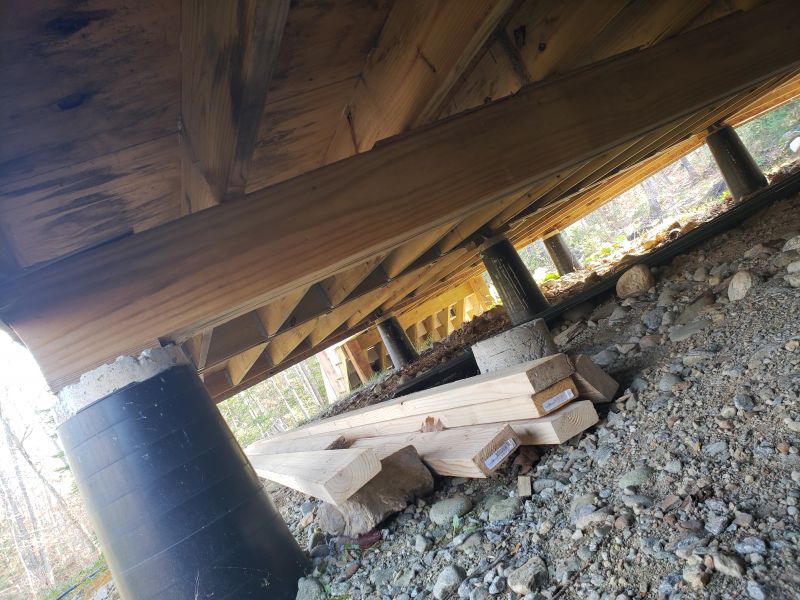

MntGoat
# Posted: 5 Nov 2019 10:28pm - Edited by: MntGoat
Better to overbuild in my mind. I bought a 40 year old building on sonotibes and some of the sills were rotted despite being 12" off grade.
When I built this cabin I did not want any issues and used PT for joists and PT decking as seen in my above pic.
# Posted: 6 Nov 2019 05:34am
What do you mean by sills? The rim board?
MntGoat
# Posted: 6 Nov 2019 05:57am
The rim board is what I am talking about, the rot did extend into some joists as well.
# Posted: 6 Nov 2019 07:17am
Thats one board i would always use PT on. I had to repair some rim boards and joists on my 1930s house as well. It could be because it had no gutters for many years or was poorly taken care of.
