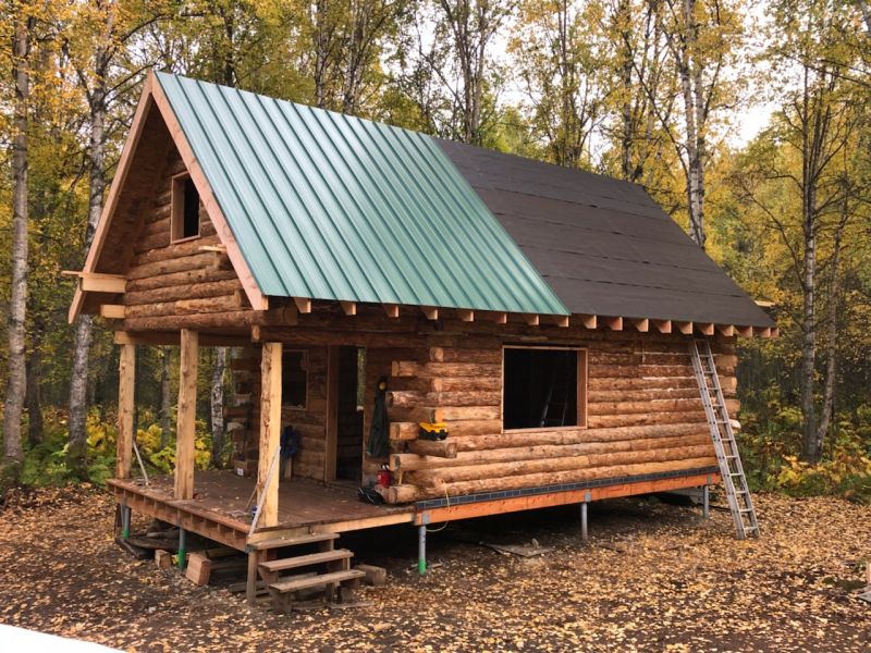

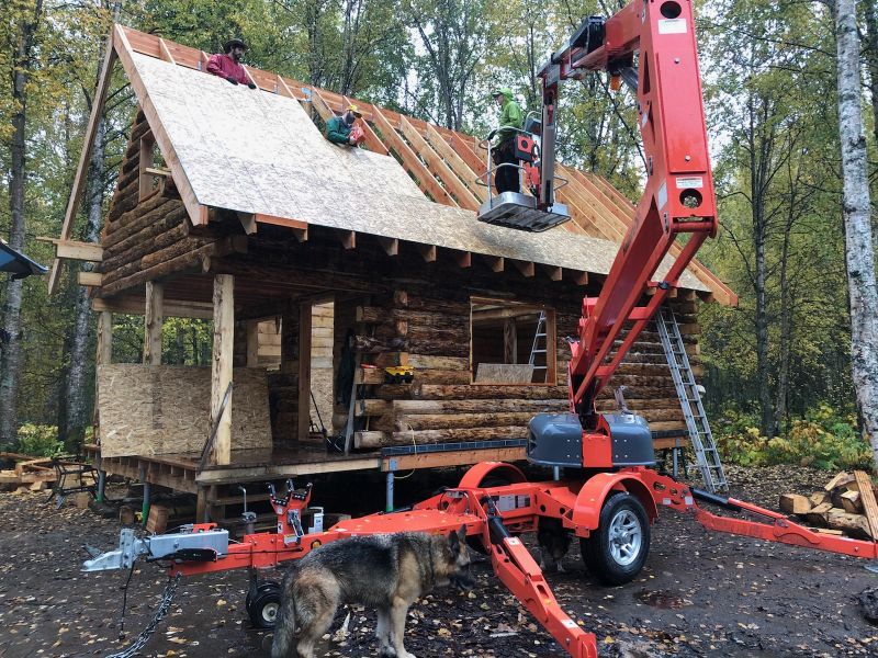

AKfisher
# Posted: 6 Nov 2019 07:42pm
I had the original plan to use fir strips, then changed my mind. Not wanting to cut corners on the build I then went with 1/2 osb and 30lb felt. My roof is steeper then yours and taller, but I would build it the same again if I had to.
I rented a pull behind bucket truck. Worked great and was much safer.
Since you are only a 4/12 (walkable) maybe rent a manlift, could put the plywood in the lift and and get it to the eave.
