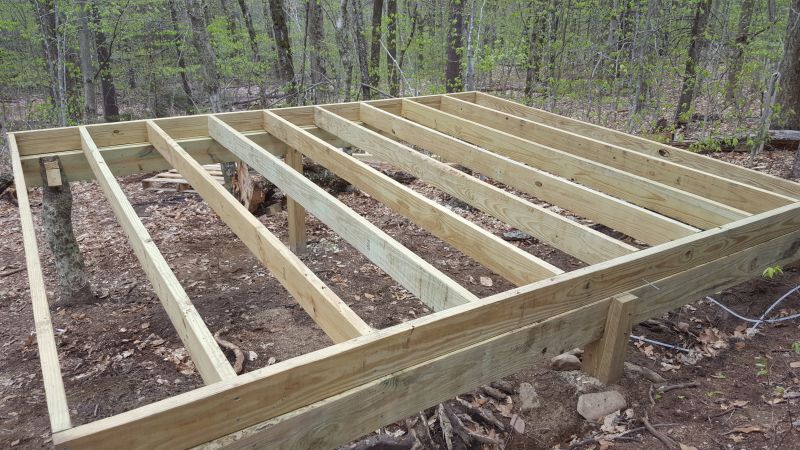

The posts shown are located on buried piers, notched and attached to a bearing beam. the joists were laid upon said beam, followed by OSB on top.
Now most of the studs are on-site and it was a smaller job than expected. I plan to use 2x6 rafters, which I had drawn up with an 8/12 pitch roof but am now thinking of bumping that up to a 12/12, which reduces my overhangs and simplifies soffits and trim. On top of the rafters I plan to attach 15/32 ply, then 2"+ of rigid insulation. Through this, fasteners will attach battens to the joists, which will serve as a support base for the metal roof. With a 10' rafter span, would a ridge board be required?
I know that applicable code, 4" of XPS (R-20) would be required for a roof assembly above the sheathing, and R-49 for the roof assembly as a whole. However, it is assumed that the interior space will be heated to 68F during the coldest three months of the year and the value is specified in order to ensure that the interior structure remains above the dew point at this temperature. I don't plan to be there then, though this makes me reflect on the cost of housing in the area. I should add that the design snow load is 50 PSF and the stud, joist and rafter spacing is 16".
Joists
Joists
mj1angier
# Posted: 28 May 2020 10:18pm
Are those tree stumps?
waldenite
# Posted: 28 May 2020 10:30pm - Edited by: waldenite
Yes, they will be debarked and treated, then replaced with posts in due time.
